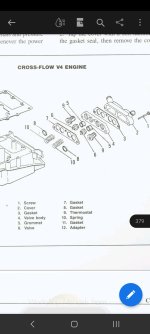

Put my thermostats in. I'm a bit confused by these cork gaskets I have put them between the engine and thermostat as indicated by this diagram (gaskets are number 8) but I've seen other people put the gasket behind the stats (between the stat the and plastic block).
Did I get it right?
