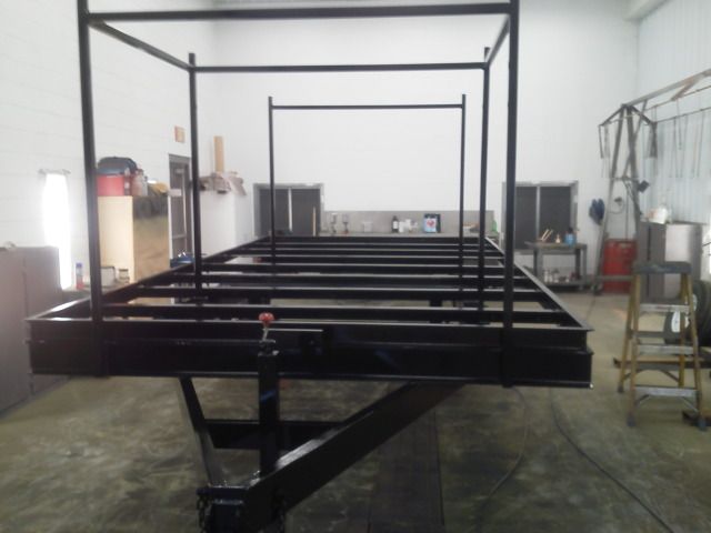

Gotta prime ladder rack first then the rest of it
Got the rest primed, my son Cody got his first taste of the spray gun under the trailer, good place to learn. Last coat of primer on at 3 pm, boys are whooped and got a ride home, so on my own and got a hour to kill before I can shoot color soooo, on to a little problem with the tilt trailer. The catch for the tilt lock was broken and I did not fab it in when we did the marathon trailer rebuild.
Got that taken care of and painted black, also painted all the hardware on the trailer that was not black, only problem I got with it yet is I put over sized rollers on to make a nice landing pad. Only have two of the 12" rollers on it need two more that have been back ordered at Ritchfield trailer for two months!!!!!!!!!!!! What the heck!!!!!! oh well someday. Back to painting at 4.15, Two coats of color and it is 6.30 pm cleaning the gun and out of here!!!!!!!! (picked the boat and boys up at 6.30 am)
Any color you want on your trailer as long as it is Black!!!!!!!!!!!
Wish I had more progress to show on the boat but it is what it is!, we will rock out over the next coupla weeks and get it a long ways. Two week goal is to have exterior of hull painted white and on the trailer, floor and foam in and sides and seat boxes figured out!!!!! YA RIGHT, I hope so, need to get this thing closer to completion, spring trolling bite is coming!
See ya, Mag out!

Ya, if it's that hard to get off I'd leave it too. I wouldn't worry about leaks with the inside being done.
That is one serious trailer you are building.....
Ya, way over kill, our guys are hard on stuff and they are always overloaded, not gonna have something I put together coming unglued on John Q public!!! My trailers will hold it! I will get some pics up on completion, up front there is a shed built like an enclosed trailer, they look sweet rolling down the road.

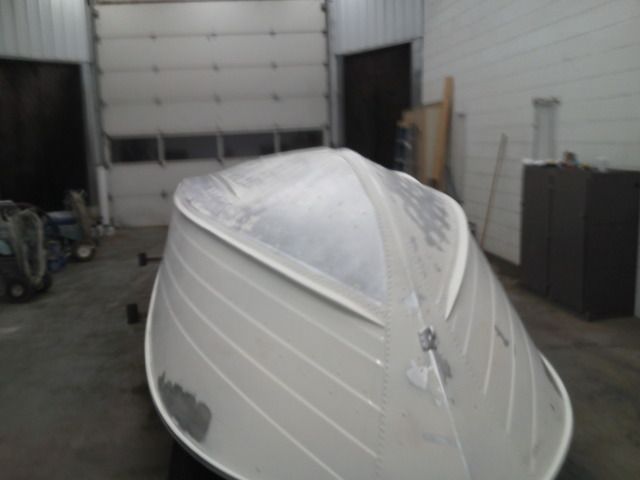

All right, got serious about prepping for primer tonight, Started out on the other end of the spectrum from the 36 grit to a red scotch brite and Scuff prep (sand paper in a bottle) and a bucket of hot soapy water.
Turned out ok, washed it off and let it dry and still had more sheen to it than I wanted, so moved on to 320 wet dry paper and my bucket of hot soapy water. looked a lot better!:) moved on to an acid bath with my aluminum eater, worked mint. first coat took all the discoloration out of the paint that would not sand out, second coat bubbled up some paint and the pressure washer blew it off. So went back and scotch brite the whole hull and rinsed off. Moved it into the paint booth to dry!

Couple more pics for posterity before paint.
And the funny of the night, not gonna be legible in a picture buttt found a previous boat name that showed in the sanding, get this at some point Ol 76 was named.............................CHUBBED UP!!!!!!!!!!!!!! LOL
OH MY!:eek:
Was here
Any who, got some side stuff to do tomorrow night, still gonna try to get it primed with self etch! That will make her look different!
Hard to show sanding progress bur I feel good about it,
Cya, mag out!

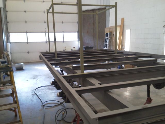

Speaking of etching it rrumba'
1st coat
2nd coat
at 8 I can get a nice thick coat of Majic grey primer on!!!:D

Great looking etch primer!
