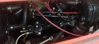

It ratchets both directions in both FWD and rev. Definitely needs checked. 😬

Seems something is indeed shot. Went through the adjustment... even with the lower cable stud all the way up (which is how it was originally), I can't get engagement in both directions with the throttle lever. If I manually pull the lower cable, it does engage as it should... so lower cable gone sloppy?
