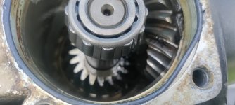

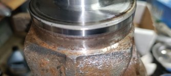

Got the drive apart... Funny, the part of the yoke that rides on the seal looks fine...
Unless that rusty groove under the shine is the surface in question. Sleeve it?

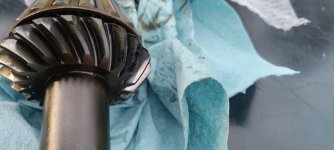

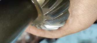

The gears have some very light pitting:
Nothing massive... But still ok to use? The bearings feel great... Smooth as silk.

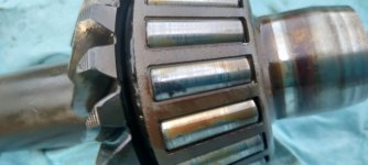

The other issue is that I found more pitting. Lower bearing and the gear nearby... See attached pics.
Maybe fetching a used outdrive isn't such a bad idea? Seems like more and more bad parts...

Speedy sleeve for seal surface
Need a bearing splitter to remove it from the gear

You think my gears are still worth using? I don't recall a lot of gear noise... but the pitting is concerning. If it was just one pit (or a few in one spot), I'd think nothing of it (the cam in my truck was like that when I rebuilt said engine... still going strong). But several teeth on both gears have a lot of shallow pitting.
alldodge
Mar 8, 2009
44,643
I don't see enough pitting on the gear posted to give me major concern with the motor you have. If there is worst spots then could be and I'm not there look and feel
I showed the worst... but it's like that on several teeth on each gear. If I just need to replace bearings and knock that stubborn seal, then sure.

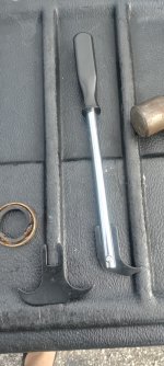

Got the seal out. Had to modify a harbor freight seal puller:
Also got a bearing splitter for the vertical shaft. How does one remove the bearing cups from the case and cover? Slide hammer? Special tool?

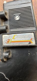

Got it. Not as good cosmetically (lower unit has corrosion) under the paint) but no leaking u joint. Plan will be to swap my lower over... Maybe reseal the upper since I have the parts?
Obviously I'll have to keep the case and gears together since I don't have a shim kit...
Edit: maybe I want to just salvage gears and yoke after all. Upper case is pretty chewed up. See second pic. Maybe between both I'll have enough shims to be able to make things right. I do have a test indicator that I used for setting backlash on my truck's rear end earlier this year...

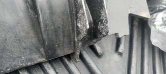

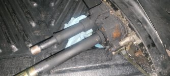

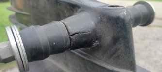

Good news: the oil coming out is water free but looks like generic yellow/orange gear oil.
Bad news is the u joints are bad and the upper case damage is worse than I thought:
Both sides are cracked. There also is corrosion in the bell housing gasket area.
Making a case and joint swap with the old drive tempting but not sure if worth the trouble of having to check shimming. But replacement cases are a thing they sell, so it's justified on at least some cases?

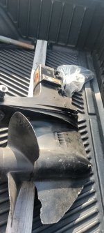

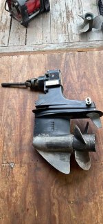

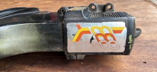

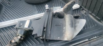

We'll see if I can get a day off... The drive does legit look better than this one. I've attached the pictures from the listing. No corrosion, just lost paint. And the U joints look very clean. 3rd time's the charm?

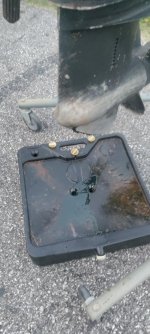

First, I drained the oil... looking really nice:
At the end a bit of moisture, but hardly anything:

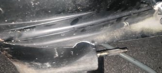

Tearing the drive down had some issues... first, bozo here hit the wrong spot with the mallet and broke the lower:
The shifting was very sticky, so this lower wasn't worth much at least. I also noticed that fully assembled I was able to turn the yoke without much impeller resistance (I was just checking for backlash, and it spun over!) Once I got it off, that mystery was solved as apparently the impeller blew up hard:
(look at the water guide tube... wasted!)
