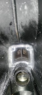

But... more broken bolts, this time in the water pocket:
I used my impact on its lowest setting. The two that didn't break I used a 1/2" drive 11mm shallow with an extension (my SAE impact selection isn't too hot). The two that did I had to swap to a deep non-impact 3/8 socket (bad ratdude!) and an adapter... which may have contributed to the different result.

Against my better judgement I tried to weld some nuts to remove the broken bolts... nope, the bolts just kept breaking internally. Once it got below flush I stopped. My nuts messed the surface up a bit, so that may need to be decked while it's in the mill.

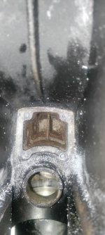

Well.. that's what I did. Using the old water pocket! And spoiler alert, it did work.
First, here's the tooling I bought:
The trick here is that the bit has a 1/4" quick-change hex shank, which can be coupled to a long extension to provide the reach/clearance needed. Other brands make them in 17/64 but they're online only. Home Depot and Ace hardware both carry the bits somewhat locally (and while I don't care for HD due to personal objections, they had a lower price and the extension I wanted). The helicoil tap and extractor both have square tap ends, but thankfully I found sockets in my collection that could drive both (a 7mm "universal 12-point" and an E5 external torx respectively), allowing me to use a ratchet and extension on both.

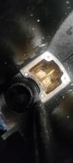

I spun the bit in the two water pocket holes to be drilled to enlarge them to 17/64 (this water pocket won't be reused- I already have the one from the original drive that I've refurbished). Then, I bolted the water pocket down, making sure the other two holes are as lined up as possible with the broken bolt locations. I drilled the bolts out until the drill bit stuck/grabbed once all the bolt had been drilled through, which happened to be just enough depth for the tap to cut enough threads to seat a helicoil.
Fixed:
I did notice the bits walked a bit in the water pocket (why drill guides are normally hardened steel, not plastic!)... but sure enough, the unmolested water pocket I'm actually going to use does bolt up:

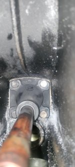

I then used a wire brush on the aformentioned drill extension to clean the surface up:
It's not really visible on camera, but the failed nut weld attempts left some gouges that didn't clean up. I'm thinking I may need to use some sealant (aviation gasket maker? "the right stuff" red RTV?) with/in place of the gasket to fill the gouges in.
Obviously it needs more cleaning (lots of oil/exhaust soot mixed with drill/tap chips)... but I think I salvaged it?
