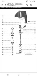

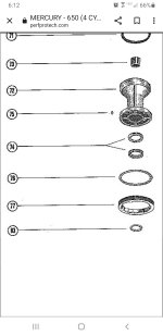

I have a 1970 merc 650 4cyl. I'm trying to replace the prop shaft bearing carrier oil and water seals. Is there any way to do it without removing the bearing carrier assy? I attached 2 pics of the diagram for the lower. #74 is the seals im trying to replace.

There are tools that can extract Seals in place. They kind of look like a piece of Threaded Pipe, fit over the propshaft and then turned, The Threads bite into the seal and then it can be pulled out. Don't go trying to use a piece of Iron Pipe, as it is too rough inside and will damage the Propshaft sealing surface
Some people will drill a couple of small hole in the Seal, then screw in a couple of screws to grab on. Again there are Risks at damaging the Propshaft.
It is safer, just to remove the Carrier

Right on, any tips for removing the Carrier? I don't have a manual But I do have a shop full of tools. I've done that trick with the screws and drilling into the seal but only on larger lip Seals... seems risky on such a small one...guess I just have to pull the Carrier and do it right
39,762
On a fresh water motor you bend one tab on the lock washer then remove the big nut.----Slide hammer and a hook to pull carrier out.
