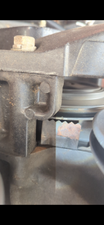

I also managed to get this still image from a video I took. Here you can see my timing mark, this is where I set it in base timing and still have pinging.

I'm unable to read yours in pic, maybe use some sand paper. My pic came from manual 13
Unless the firing order is incorrect

Firing order is correct, double checked when I installed new dist cap. I can try some sandpaper but it is a bit rusted as well.. Was just going off the notches in relation to the manual.

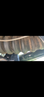

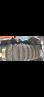

As for the leak, I inspected my bellows and noticed some light cracking. Do these need to be replaced? The shift cable also only has a zip tie on the small end, not a clamp. Potential leak area?
Naw, the zip-tie is the better way to do it, than the ole style clamp,....
Thats the exhaust bellows which is in need of replacement. Would assume the driveshaft bellows and shift bellows are in similar shape. Exhaust bellows are open to water and will not leak inside the boat. Drive shaft and shift bellows are likely cause of your leak but you replace them all while you are in there
