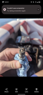

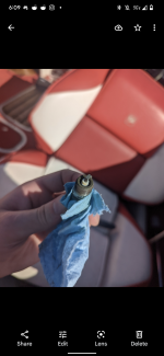

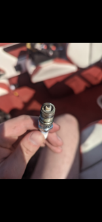

A few plug pics after a high throttle / WOT run. I still hear some chatter / rattle at higher RPMs. Not sure if it really is knock or not

Don't see a 1 BTDC mark but would agree your about 23 degrees advance
Need more time on the plugs to determine if its actually lean. Correct if I'm wrong but the plugs have very few hours on them

Okay, so timing is good. And yes the plugs have about an hour or two total on them. They're practically brand new. Think it's safe to just run the boat for a bit now? I will add that on the first acceleration of the day out of no wake, it will bog under immediate throttle. If you ease into throttle it's fine, and after that punching the throttle doesn't cause any bog.

I would suggest making the carb run richer. Increase jet size or get a larger carb. A motor won't be destroyed if it runs rich and can be leaned out later
A take off bog can be lack of fuel
Don't run it hard, maybe keep it just enough to cruse and give it time and recheck plugs

The plugs look good in the latest pics, appear to have a good color with even burn across the porcelain and tang
