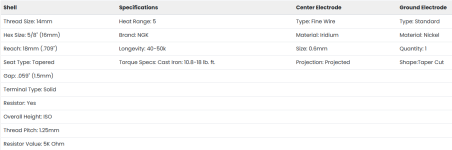

What sprk plug's do you guys all reccomend for a 350 MAG Bravo 3? Currently running a NGK TR55IX (This is what was previously fitted). See attached the specs on this plug
alldodge
Mar 8, 2009
44,643
Probably came with AC-932 but later Merc changed them to AC 41-993 and these are Iridium and gaped at 0.060
Finding the NGK TR55IX is used in the Ford F150 1997-2010, as well as older GM and a few LS1/LS6
Guess that said, the plug should work fine
