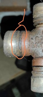

Someone know instead wich joint is this one? ( Alpha one gen2) Without greasing i sow they are selling on summit so i will buy this too
if you have the inside snap rings MOOG 315G or equivalent This looks like what you have but cannot be sure.
if you have the external snap ring moog 344 or equivalent - which I think cross references to a volvo 240/740/940 among other vehicles
I think internal , should be here (red circle) but mine is not grasable

got it should be SIERRA-18-2097 or mercruiser 805536A1
These are correct for the inner clips
These are my notes
1-6301DL Autozone (Alpha)
805536A2 permalube – Sierra 18-2097
Greaseable older Merc 75831T1 , GLM 8030 at Mercstuff, Sierra 18-2174
