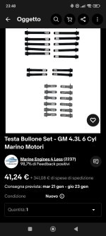

Perfect i eill buy new then. The problem is that in italy is not so easy.
You know this company?

That is correct about the ARP bolt torque specs, I used theirs not Merc's or GM's. The GM spec is 65 ft lbs, the ARP was 70 ft lbs
Torque for the intake manifold bolts on the Pre Vortec was 30 ft lbs
Lou C
Nov 10, 2002
13,977
Sorry don't know the company, but the main thing is that the threads are nice and clean. As long as they thread in well, they should be OK. Make sure to follow the torque spec pattern, etc. Since some of the bolts bottom out in a cooling passage, I used Permatex Aviation on the threads on mine.
Those look like they already have sealer on them, the ARP ones come with a tube of sealer you put on the threads.
