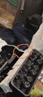

Thanks so much oil sending unit you mean the one that goes here in the picture?
Not even thread sealer?
Yes, that one
Yes that's the sending unit hole. Sealer isn't really necessary but you can use just a bit only on the threads, I think it is a taper thread type seal.
