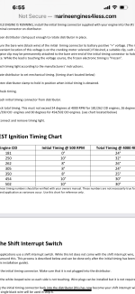

24 degrees roughly, 8 degrees base. Both still occasionally jump around
If you end up with nothing else to try I would set total advance at 30 and see what that does. I tink the delco kit states 8 intial 25 total for a 350 but I think merc for a vortec is 10 initial and 30 or so total .
Your right on the timing, I will try bumping it a bit also, can’t really hurt752D5E3C-4E70-4752-A0F5-139E7E611F10.png752D5E3C-4E70-4752-A0F5-139E7E611F10.png

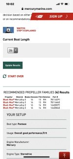

I know is a rough estimate but I went to the Mercury prop selector site and this is what it came up with for my current set up, when it had the 3.0 I used the same prop, and the calculator recommended the same prop. I have a ton to learn about props.

I have always found the Prop Calculators a bit optimistic on the amount of Pitch chosen. Then again, I do my boating between 1950 and 2400 ft above Sea Level.
