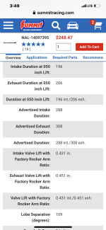

I went and bought this cam today, any thoughts or experience good or bad, Chevy ramjet cam36DD4239-D9A2-48FF-BBE9-45A3DD912195.png36DD4239-D9A2-48FF-BBE9-45A3DD912195.png

Unless you abandon wet exhaust and run jet boat headers, that cam has too much duration.
270 degrees is the max duration for wet exhaust

I have that exact cam in my vortec 350 and it is a very common cam for marine engines. Works just fine with wet exhaust. Zero reversion. Valve overlap is the issue with marine cams not just duration or lobe separation angle. I think you will be happy it is designed for low end torque with max HP at 4400

Do the calcs, this cam has too much overlap to be used as a marine cam.

I wouldn't consider it a hotrod cam by any stretch. It is designed for torque and midrange. It is commonly used by marine engine builders as a stock cam. Many people have pulled it out of marine engines, including myself.

It is at about the max lift you can run without modifying the heads. Not to say there absolutely won't be a problem, but many people run it on stock heads. Works great for me
52,787
Stock GM marine cam specs
202 duration intake
214 duration exhaust
395" lift intake
404" lift exhaust
112 lobe separation

the cam I would suggest is the one that came in the suburban motor
however if you want to buy one, look at this one:
lobe separation make sure that there is no reversion. profile of cam is a short base circle with high ramp rate.
the XM270HR is the next cam up, however you need more torque down low and the XM270HR has some reversion issues at idle, and you are in a pontoon where you will be idling along often
Here is the overlap on the ramjet cam - 19 degrees total overlap which means that if you idle, you have reversion.
Here is the Comp Cams XM270HR with 3 degrees of overlap. this cam does have some reversion at idle and is recommended for jetboats

I was having trouble with that cam calculator web site last night. Kept getting a message saying it was down for maintenance. But I'm really confused. Maybe I'm not thinking correctly or reading things wrong, but the numbers indicate to me that the 395 cam with less duration even with the LSA of 109 gives less overlap (-17 degrees) than the XM264HR (-9 degrees) and definitely less than the XM270HR (-3 degrees). These numbers are using .050" lift and I understand that by definition, valve overlap is calculated using advertised duration and not .050" duration, which would put the 395 cam at 80 degrees overlap, the XM264HR at 43 degrees, and the XM270HR at 49 degrees. 80 degrees definitely sounds like a lot but that's due to the advertised duration of the cam of 288/308 which on the surface appears to be more of a high rpm racing/hotrod style cam, but it's not. With .050" duration of 196/206 It's a mild, low-end and midrange torque cam with a smooth idle. Perhaps the way GM measures or calculates their advertised duration is different than other manufacturers but I do know that many people, including myself, use this cam in marine applications with wet exhaust and don't appear to be having any problems.
