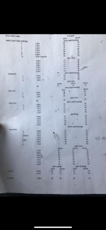

What ratio do you think I need for the boat and engine?

Maybe I should retract for a minute.
With the old drive was the boat on plane at 25 MPH?
With new drive at 18 MPH is the boat on plane or plowing?
Can you get WOT of 4800 rpm
