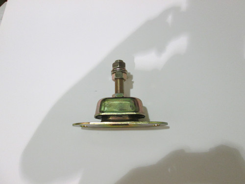

I have a 1988 Sea Ray Seville with a 4.3L V6 Mercruiser. Sadly one of the front engine mounts has rusted away on the bottom plate so time to replace. These are the old type of mount.
I've done the usual Googling for a replacement pair but can only find HGE aftermarket here in the UK. Trouble is the website I'm looking at doesn't specify which model they are for, but merely gives a weight they will take which is 160kgs with a 16mm stud. Here..........
https://repowermarine.com/index.php...exible-engine-mount-160kg-with-16mm-stud.html

Ayuh,.... Welcome Aboard,.... I'm 99% sure that's the mount used with the pre-balance shaft 4.3s,.....
Yer replacin' both of 'em, Right,..??
You'll have to do a motor alignment when you do,....

I doubt my engine is a pre balanced shaft version (how can I tell)? so do you think the mounts I showed you would be suitable? They seem to go by weight now rather than marrying to a model number.
1/ Will 160kgs (352lbs) be sufficient?
2/ Also, something that's bothering me is that the mounts seem to be bolted to the wooden mounting blocks, please tell me they are not just bolted into the wood and they have captive nuts of some sort.
3/ Can I use the later type of mount on an older engine?

1. should be, guessing that's weight per mount = 700lbs
2. most mounts are held down with 1/2" stainless lag bolts and sealant/adhesive
3. possibly, some of the non balance shaft 4.3 used a fluid filled mount, easy to ID by the cable straps fore and aft of the fluid bushing on the mount.
Do your current mounts look like the ones you posted in the link?

I just realized, you live in the UK. The HGE1609 that is shown in your link is the correct mount. I compared all the measurements to mine. It is identical to mine and mine is a perfect fit and as good or better than the original. Go for it!
That's great thank you for all your help. We sometimes have to order from the US as UK doesn't always supply, but in this case you've put me right with my UK supplier. My only concern with the HGE is that the cover and base plate are only Zinc coated, however I have some two pack epoxy paint which should provide good protection against our nasty salty waters.
