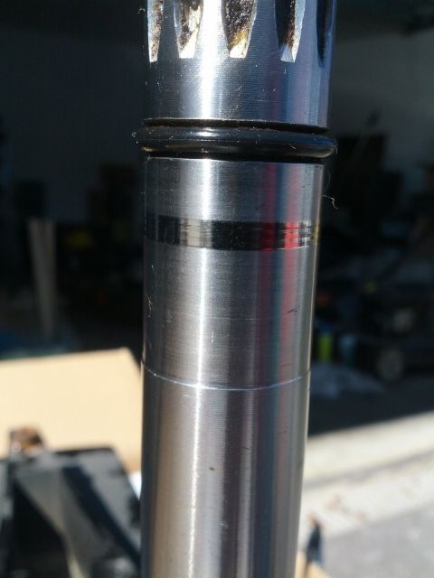

Today I got started and my first task was taking out the sea water impeller assembly from the lower unit. I plan to replace the entire assembly. However, I'm a bit concerned with the vertical drive shaft. Visible wear is apparent on the shaft where it rides in the upper housing bearing seal. Of course, looking in the upper housing, I found the bearing seal was torn and half missing. I also noted the bearing seal did not appear to be flush with the gear housing (one side was low) which is probably the reason for the failure.
1. How is the condition of my lower unit vertical drive shaft? Requires replacement, or should be fine?

1. its fine, just clean it up with some emery cloth
looks like a little wear there. to bad the seal was cocked a bit. it wore more shaft than what i've seen on the 2 mc-1 drives i've had. anyways. one of my drives i put a speedy sleeve on. i think it worked however that drive wasn't in service for long due to a whole boat disintegrateing before my eyes. the other drive is still in service right now. that shaft had seal wear too. on it i dropped the seal off in a slightly different location and got new surface for the seal to ride on that way.

Another additional note: As has been very widely discussed in this forum, it is highly recommended to remove and discard that O-ring that is shown on the vertical shaft in your photo. It is essentially not needed because of the shaft seal you are discussing, and in later alpha models they did away with the o-ring groove altogether (it has been known to be a weak spot in that shaft). The o-ring actually hinders reassembly of the drive and in many cases ends up distorting or getting caught in the seal it has to travel past during insertion.
I concur with ziggy...the shaft looks a bit worn, but looks smooth enough for reseal with a new seal, and you have the option of seating the seal in a slightly different location to get a different bite on the shaft (been there, done that). That seal is not actually an oil seal (the oil seal is actually above this one in the upper half); it's function is to keep water out of (and keep grease in) the shaft spline area. Good luck!

Just curious, does anyone know if the vertical drive shaft in picture #1 has a step on the upper end (where mine has been worn/polished) like the step that is clearly just below? I assume the stepped down region is precision milled for the seal(s) and if there was a step in the worn/polished area I will need to avoid pressing the new seal in too far so that the new seal rides below (referenced to the picture) rather than above the worn/polished area. Hopefully that makes sense.

no step on the driveshaft, just clean it up where the old seal rode and you will be fine
