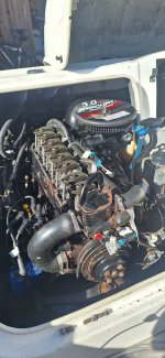

Update picture almost there🙏

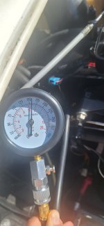

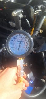

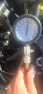

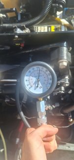

Hello all my fellow boaters! Excuse my absence, got caught up with school work... Im sure you guys are all wondering if I got the boat to run... or well explode lol. Im happy to announce that its all running! I got it all running and dialed in on Saturday. Worked all day on it but it payed off. Here's a video of it running, this is a cold start without pumping it and no throttle. Last time I started it was on Saturday for the very first time. I started it again since I'm doing an oil change. Id like to thank you everyone once more for all the help and support!
NOTE: I still did not check timing, I'm getting a timing gun tomorrow will get to that. My guess it is still off.

Great work! I did a similar job on my '88 4.3 V6 back in '17. The cleaning and parts inspection are important, as is keeping everything organized. I would consider cleaning the carb, I think with your compression test results as consistent as they are now, it should idle smoother. Also, be careful about setting timing, make sure it's right, these engines are susceptible to detonation and that's one of the main causes of blown head gaskets. I do think yours may have been done before, because I don't think Fel Pro is the OEM on a Mercruiser. Beyond that to avoid another blown HG, make sure your boat is propped correctly, in that it reaches the specified WOT RPM at full throttle. And, despite what Merc says on an engine known for blown head gaskets and detonation, use at least midrange fuel, meaning, 89 octane instead of 87. So, the things to keep in mind to avoid a recurrence:
proper timing
use good fuel, 89 octane or better
engine must be properly propped and reach the specified WOT RPM as per Mercruiser's spec
inspect spark plugs for proper mixture, you don't want the engine running too lean, that also contributes to this problem

Thanks Lou, I've done the timing on it, set it to 2° ATDC as it said on the carburator air filter(Before doing timing, I checked the mark on the crank wheel and it was WAY back my guess about 25° BTDC at idle...) Ive also set the idle RPM to about +/- 750RPM. I than plugged the wires I bypassed back together and revved it to about 3000-3500RPM and the timing advanced to about a very steady 12° BTDC. From what Ive looked up and researched thats how it should be. Also the carburator looks to be brand new and its OEM so I dont think I have a problem with the carb. After doing the timing it starts like an EFI engine lol.
