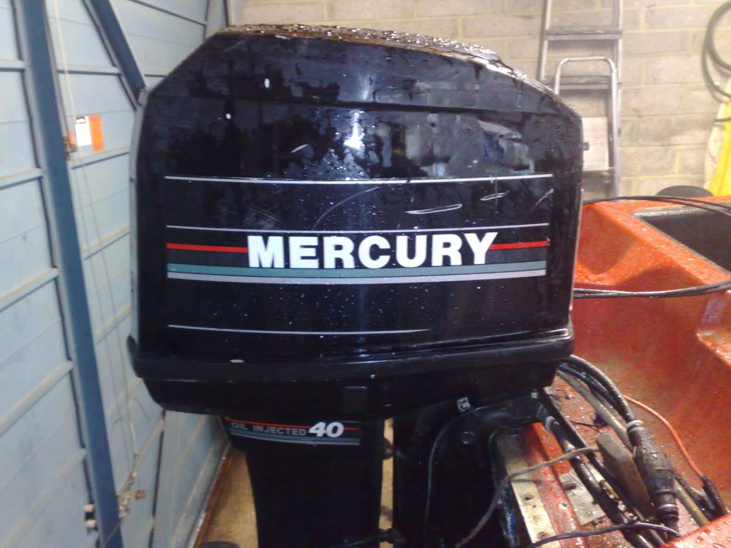

it has 4 cylinders, 40 hp , oil injection says classic on the engine cover and as said it has 1990 on the starter motor if thats anything to go by im not sure here is a pic of the engine

Ok that looks like a 86/87 40 HP, Those engine had the serial number stamped on a soft plug above the port stud of the bottom carb or on the block at the crankcase seam, top port (exhaust) side
