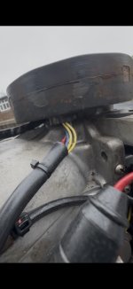

I've just pulled the flywheel to inspect the stator and found this. Doesn't look great, right? The areas that are rusty seem to have separated slightly. Also the area on the outside of the Stator in this location, has started rubbing against the inside of the flywheel - perhaps this signifies rust and bad things occurring inside the Stator?

Stator doesn't look bad to me, but I'm no expert. Don't see how putting it in the water causes the issue when it runs fine on a hose or in a bucket. If it was overheat issue it would take longer than that

Aftermarket stator and someone stripped 3 mounting bolts amd replaced with metric ones. Also a 93 should have a 40 amp stator , yours shown is a 16amp, if you are running a 40 amp flywheel it will overload the switchboxes and rectifier

The stator was toast, I replaced it with a new CDI Electronics 16A one.
Also did the same with the pickup, went CDI again.
