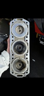

Mercury V6 XR2 - Does this Stator looks bad?

Latest theory (new coils). Changed things, but didn’t really improve things. It’s bucking when trying to accelerate past 4K RPM’s now, a very defined miss-fire. To rule it out, I’m making a new loom between switch boxes and coils (mine is original and 30yrs old. Could have an intermittent break in the wiring. Whilst I was at this I pulled the exhaust chamber cover. All clear and looked fine. Pistons sides looking really clean and new.
Interesting what you say about the plugs / water getting into cylinders - all 6 of the plugs are really clean and never seems to carbon up… it might also explain where all my cooling water is going (lack of meaningful flow) - at 4K RPM it’s not even registering 5PSI on the water pressure gauge. What pressure would you expect at that RPM? I’ve just ordered a complete OEM water pump kit with new housing and gaskets. I only changed the impeller last time.
Also, where are the likely areas of water intrusion into the cylinders? Heads gasket is one I guess, but any other likely areas?
