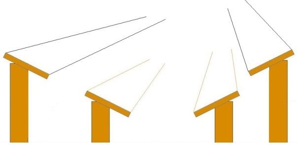

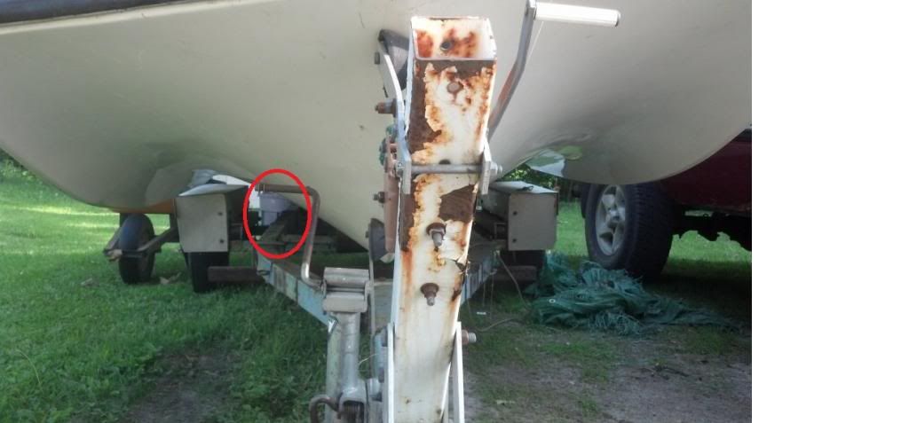

On your trailer in the area circled, you'll need to fabricate some sort of bunk supports similar to the drawing shown. Either out of wood or have a welder weld it up cuz you'll eventually need a trailer to fit the boat appropriately.
