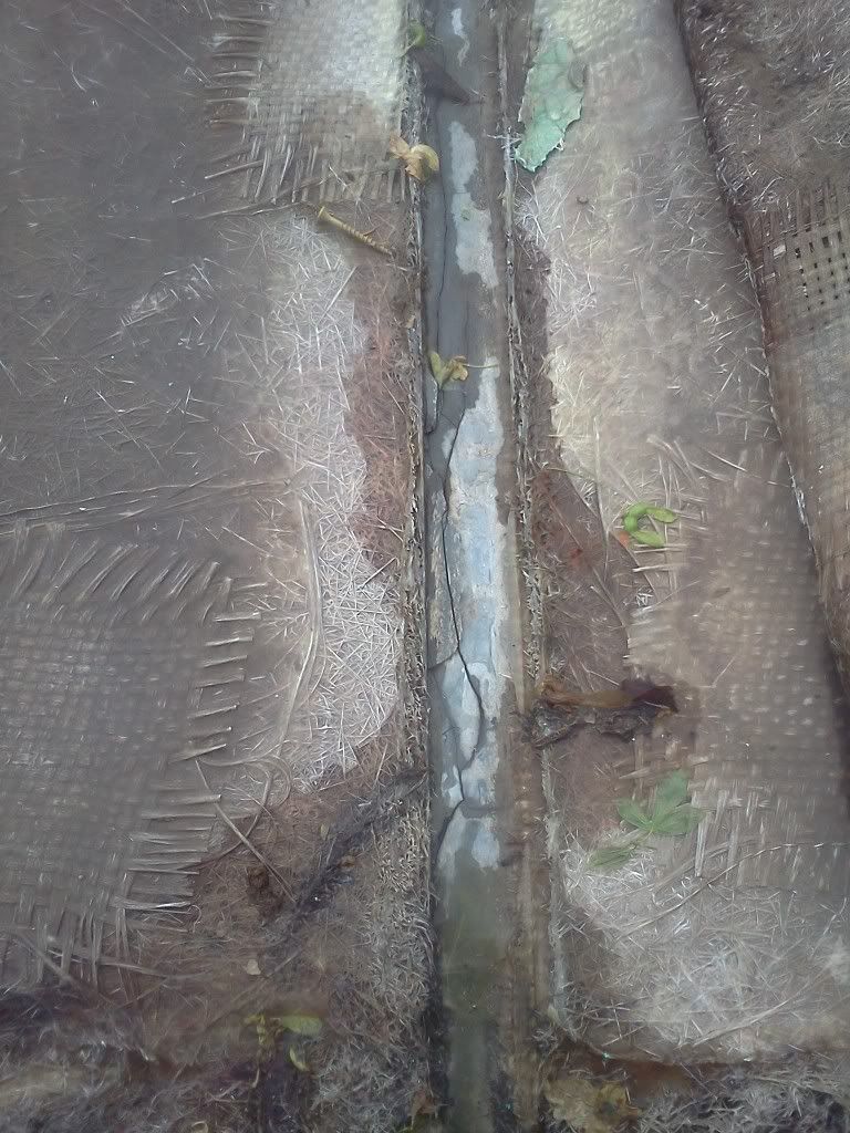

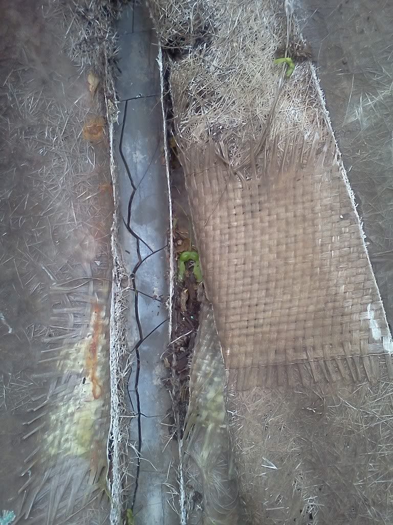

  1. is there any need for concern or how do i fix this .it looks like a coat of resin is what has cracked . the crack runs the the entire flat portion of the middle stringer location i have checked the entire exterior of the boat and not so much as the slightst sign of a crack. and due to an recent experiment i know the bottom is water tite
Woodonglass
Dec 29, 2009
25,930
Re: my first time replacing a transom were to start
Nope nada to worry about. Grind it all out and bed your new stringers. It's fine.

when i took this one i looked closer and what ever is cracked is about 1/4 inch thick at most and is semi clear in color. i have no idea how to change the size of the pic but schroll down the pic is taller.

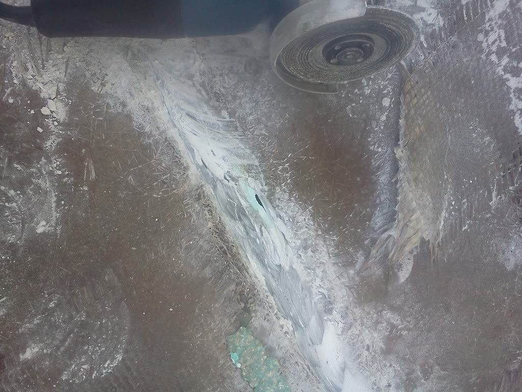

i hit i low spot in the bed and went strait thru the hull :facepalm: is this repairable and is there an easier way th remove the old bed

No problem. Put some duct tape on the outside to keep the resin from oozing out and then mix up some thickened resin and smear it over it on the inside. then a layer of 1.5 oz mat and a layer of 1708 cloth. You can fix the outside later.
