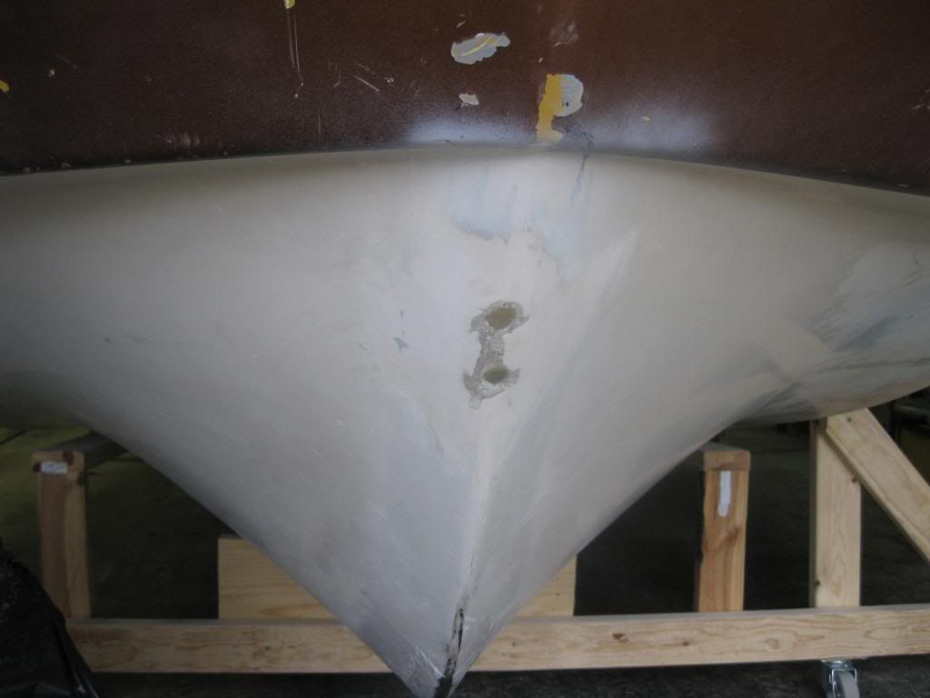

Hey denlynn. Nice work on the bow eye and that's a great looking cradle. Glad your making good progress.

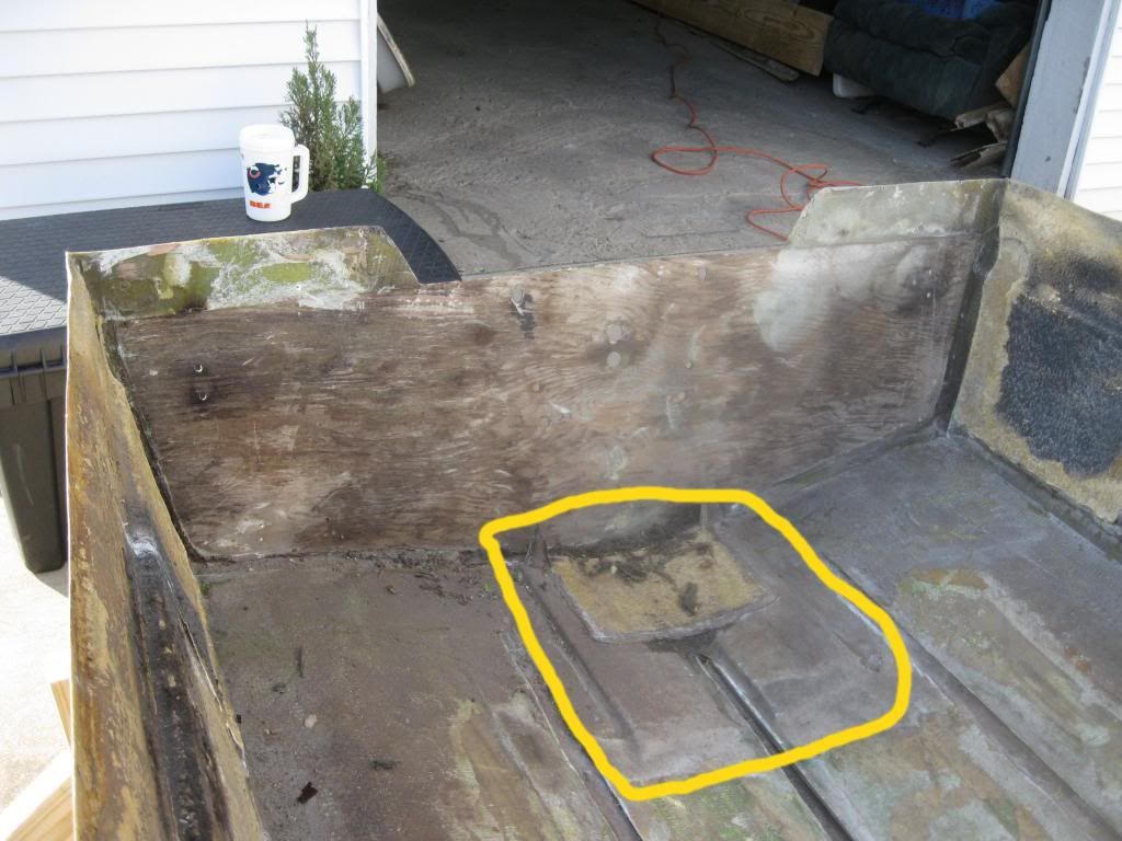

Something I just noticed looking at this pic and have a question. Inside the yellow area WAS a raised, maybe half inch, ply wood core that the box is built on. I had really forgotten about this and wasnt going to replace it. Now Im thinking it must have been there for a reason... strength? To raise the water to the drain hole....? Or will it hinder drainage...? hmmm. I guess it was there for a reason and I should just put it back the way it was :p
Woodonglass
Honorary Supreme Mariner
Dec 29, 2009
25,933
Re: My project, 74 Ebbtide
Yup, Respirator is a Must. Ventilation...Always!!! Plywood at the bilge...Make it just like it was. That's my opinion.;)

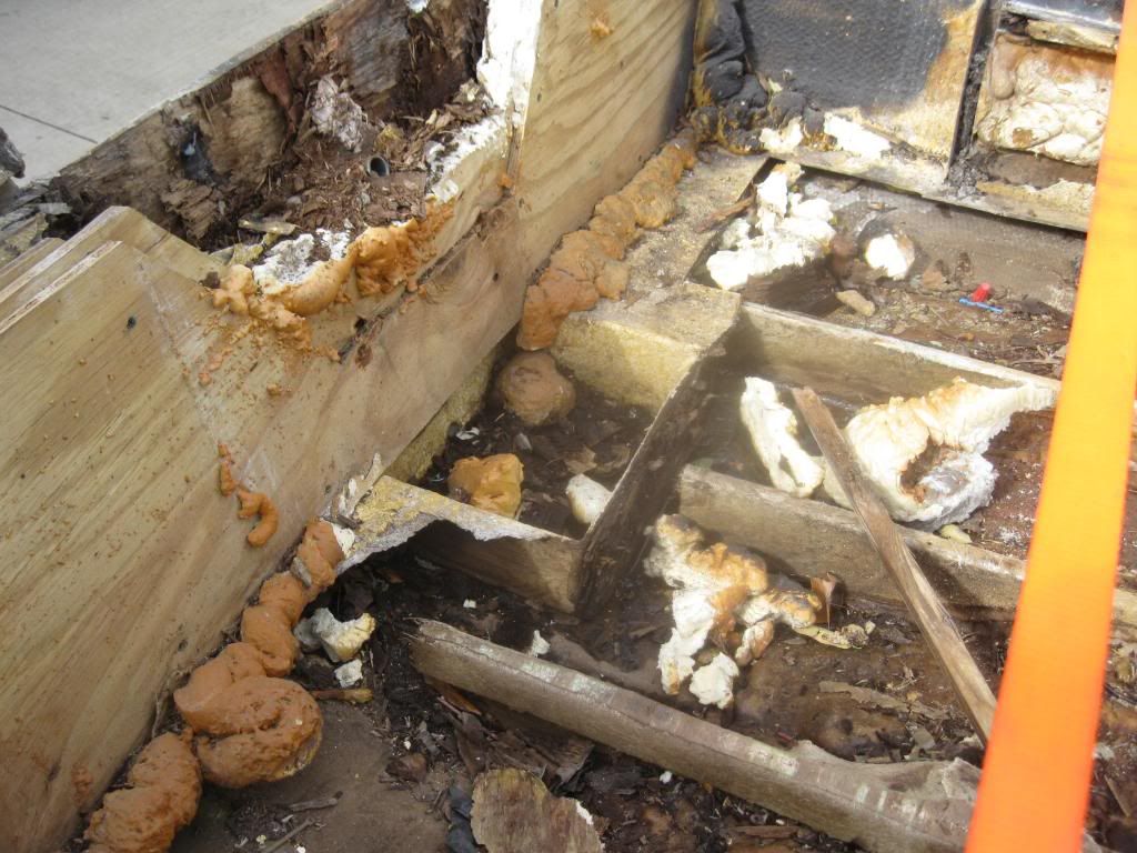

Looks like the interesting repairs continued along the hull bottom~hull side area too. Great Stuff isn't so great in a boat :facepalm:
