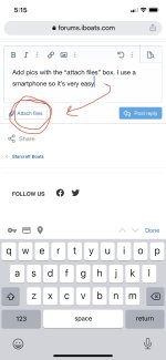

Add pics with the “attach files” box. I use a smartphone so it’s very easy

Thanks. I figured that part out, its the size of my photos.
