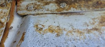

Is this a corrosion hole?
Good eye! I'm not sure. I didn't notice it until the photo myself. Alot of the black specks are debris, but I know exactly which spot you are speaking. I haven't had a good day to get in there. No dry storage and Its been raining every day since my first post.. over a year ago. :/ ill update
