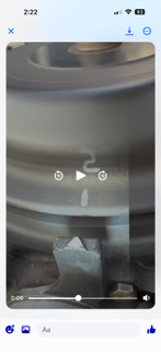

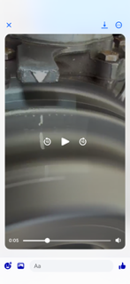

So last year the motor was running rough. So I decided to buy the repair manual . I am
Mechanically inclined , so I also download a video from Brandon’s garage that shows you how to adjust the linkage back to factory settings. I also have removed or deleted how ever people put it . I have ran all new fuel lines through out boat. Tank is in the center console . Rebuilt the carbs with OEM kits. 2 carbs . Found out they had 2 diffrent jets in the carbs . Top was to be a 55D , bottom to be a 56D . I have replaced with (2) 55D . I do have a 56D.
The air mixture screws were set to 2.5 turns out , motor will not run . If I spray starting fluid . A tiny amount ( washes out the walls ) it will fire . So that told me gas issue . Took carbs off double checked , all good . Checked spark blue . So figured air screws . So they are turned out 4 turns . It idles it idles at 900 rpm in a garbage can of water . Timing is spot on . Have marked cyl 1 & 2 on fly wheel. And used timing light to
Show they are firing properly.
My question is why out 4 turns ????

Sorry here are the two videos . Grabbed photos last 2

Are you pushing the key in and holding it in while cranking it over?----Simpler to do and the same as spraying starter fluid in there.--Timing at idle is when throttle plates open,------Timing at idle really does not matter and will show correct even with a sheared flywheel key.
If the flywheel key was sheered wouldn’t it be out of time for the magnets are telling the aystem
When to fire properly ?
As for holding the key in for the primer , at this time the primer is not hooked up. I have to replace seal . Don’t is
Not on motor at this time .
Honorary Supreme Mariner
39,985
Facr---If flywheel key is sheared the timing light does NOT show that.

Thank you for the reply’s. No matter what I do I can’t get this to idle nicely or even good . It is a 2 stroke . lol. I looked under flywheel seal is not leaking . I have had the motor running and sprayed carb cleaner around motor looking for vacume leaks . Motor never sped up . The timer base and stator read fine with ohms . So you can only rebuild the carbs 10000 times . lol. So the only thing I can think is possibly the charge coil or stator are
Failing intermittently .
Timing shows perfect for TDC CYL 1. I marked CYL 2 on flywheel. That one shows firing on time.
Did the Joe Reevs WOT shows up at 19 degrees as it should . So anyone want to shoot a good idea of what else I am missing . I am hoping to get this resolved .
