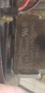

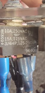

sticking with the Nav anchor lights...the Helm switch is a toggle...left is Nav, middle off, right anchor...bow is the same type toggle...but they have it set going up and down...up nav, middle off, down anchor...

It looks to me like both switch 1 at helm and 1 at bow are both DPDT switches...the reset switch is just a in out of course...the colors are grey/black-Nav....grey-anchor...orange/grey- nav/anchir SW +...I have traced them...but some of these wires have been cut and my brain isnt quite understanding how the 2 switches work together...thanks for the help
