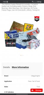

I have a mercruiser mcm 180 on an old boat our family had wich was neglected now i want to restore it but the engine is seized, can anyone help me find a rebuild kit ???

A seized 3.7L is a boat anchor, basically not rebuild able or worth it really.. It shares the cylinder head, rods and pistons from a Ford 460, and those parts are easy to get. BUT the camshaft and crankshaft are not standard parts and have not been manufactured since the very early 1990's
A 4.3L is the replacement just not a drop in, but a 165 inline 6 would also work.

So your telling me that if the camshaft and crankshaft are ok it is possible for a rebuilt and if it is is it worth it tho ???

Ayuh,..... Welcome Aboard,..... Probably not,....
The most common part number for the 470 motors is NLA,....
52,815
The cost to rebuild a 470 motor is more than buying a much newer and reliable 4.3

Before i try buying parts i just want to clarify so i wont be mistaken i have a 180hp engine with 224 cid thats a 3.7 right ????

Ayuh,..... The handle given to the 3.7l motor has been the 470 for years,.....
52,815
yes, same motor has output of 165, 170, 180 and 185. the later having the 4 barrel.
Mercruiser calls it a 470
however it is a mercruiser only cam, mercruiser only crank, mercruiser only block, a mercruiser only front damper, a ford FE head with a hole drilled in it, ford FE pistons and connecting connecting rods, a GM flywheel
so if parts are not available from Mercruiser, they are not available.
the reason the motor is frozen is most likely because it overheated and water was in the pistons when the motor was parked a long while ago. sitting neglected just makes things worst.
however prior to looking at the motor, make sure the drive is pulled in the event the drive is toast.
