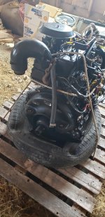

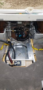

Thank you for the help. I got it out with a front loader. Lol

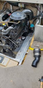

I tried to get the motor in and could not get the exhaust to line up. It kept coming out while managing the elevations for front and rear and left and right.
So it's in and mounted. What do I do with the exhaust? Is there a way besides taking off the manifold riser?
Ayuh,..... Slide the boots up/ down, insert the pipe, 'n reposition the boots again,....
Btw, it looks like there's a hole in the top boot,......

Thanks Bondo. I see the hole now. Thats from using a backhoe bucket to lift. Its a 1971 international. Not very smooth any more for this type of lift.
I will try looking up the parts and replace upper and lower. Soap em up and give it a try.
