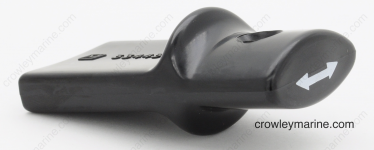

As per above, even with engine fully tilted up, it cannot be moved to either side, it feels firmly stuck, unless I am doing something wrong, but on it, it just says to move left or right, with engine up, I cannot move it either way all of a sudden. Am I meant to pull it out first?
Here is a picture of it, but even with engine fully tilted up I cannot dislodged this Tilt Support Bar.

For some reason the Trim Support Lever (which is original but different to the manuals), will not move left or right to its correct position to be out of the way for the engine to be trimmed down for normal use.

There are no springs or pins supporting the weight of the motor. The plastic knobs rest on the port and starboard brackets.
See the arrows on the end of the lever? No pulling or pushing, the lever flips - Have you tried that?

You mean a socket wrench? (thats what we call them in Aus/NZ). Which side, the starboard side doesnt have a handle, just the lever, it also has an open bolt, where the port side where the lever is, is flush to the end of the pin/bolt that goes through the engine bracket.
I think you mean the port side where the actual lever is (it has a little rubber handle), this side, the bolt is flush with the end of the lever, not sure how it is held on actually.
Yes, only moves with a hammer. My suspicion is prior owner had tlted it down too hard onto the support levers. The Starboard side I have freed up a little by loosening the bolt, but this port side as above with the handle, just wont budge unless with a hammer. It was working when I bought it. I suspect some how the actual levers are bent, but without a service manual I do not know how to take this handle side off and tap the main pin/spindle out to check how bent everything is.
