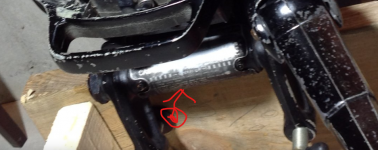

There are two nuts have been removed and the third bolt on the top but I could not get any Allen key to fit on. Any suggestions to get this bolt out ?

GA_Boater
May 24, 2011
49,038
I think the allen bolt is 3/8". All my Mercs are that size.
A serial number is more important than the year of a Merc. What serial number is on the plate between the transom clamps?
39,461
There is a bolt hidden under that trim tab.------You have to get this tab off.-----Or bring it to a shop!
Force 120
Jul 20, 2009
115
Finally locate the third bolt which holds the trim tab. This is 5/16" socket head cap screw. Then there is a third nut behind the trim tab. After removed it, the lower unit came apart. Note: could not find the serial number anywhere on the motor.
GA_Boater
May 24, 2011
49,038
It's on that plate.
