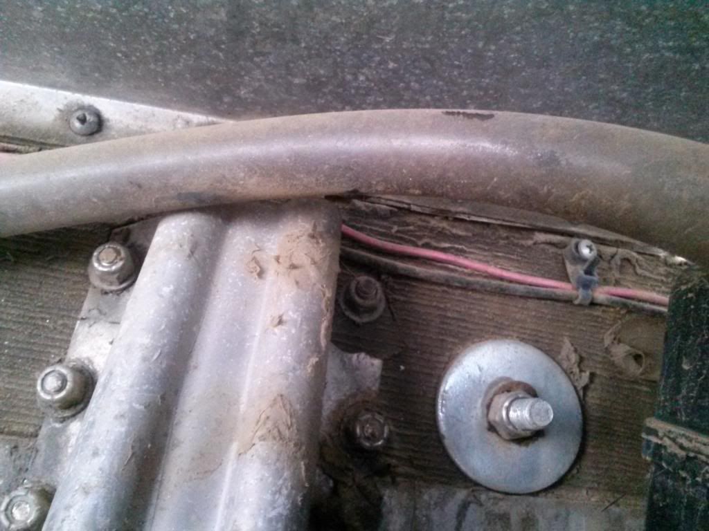

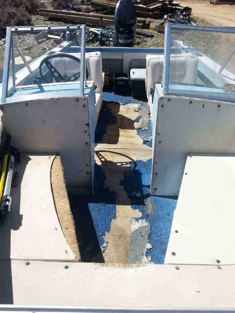

Hey there everyone!!!! I just picked up this beautiful POS the other day and looked good at the time!!!! When i checked her outthere was a bunch of stuff under the splash well and looked as best i could without pissin the guy off...(i had already talked him sown from 1200 to 550 for valid reasons but nothing i though was beyond my grasp. Well i decided to do some digging and checked out the knee brace.... now im at a loss.... on one side its completely broken off at the top between the top 2 bolts and on the other side its broken off completwly.... is this worth fixing???can i simply just weld onto it?? Or is there other things to look for and do? Ill post pics in a bit but thought id just throw it out there. Long time iboats reader first time poster.

We need some pics to kind of tell you what we think. There isn't anything on here that we haven't seen and/or fixed. Bluefin 16 is our resident structural specialist.
89 days ago I drug in this piece of carp.
as of 13:15 today she looked like this.
So can it be fixed absolutely.
Usually with a knee brace standard procedure is to rivet new aluminum angle to the old knee brace.

You have all the templates, you can either rivet new aluminum knee brace, or take it out and to a machine shop they can make an entirely new one.

Very fixable, BM. OH - Welcome to TinLand, home of lost causes rejuvenated.
Transom wood, floors and metal repair and she'll be well on the road to recovery. BTW - how is the splashwell? Often when the knee braces crack, so does the S/W.

hahaha! thanks! tin land is like home to me!!! ive fished out of a 68 14' valco tin that i did all the work on! the splashwell all cracked to heck! i was just gunna take it out and have a buddy weld it back up from the inside, then apply a thin layer of jb weld on top of the cracks after the weld to make it look good again. or is there a better way of doing this?

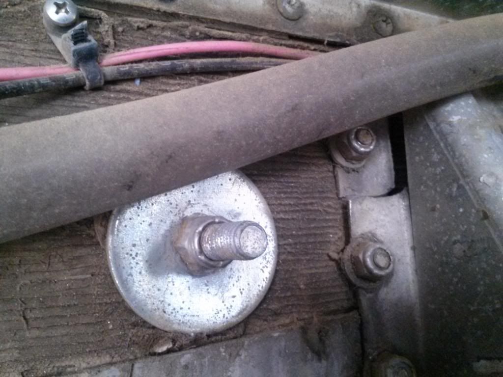

and one of the transom caps is cracked too >.> i think the PO wasnt all there... overpowered with a 115 i6 and a swim step improperly mounted that he said people would just sit on in the water... the rivets holding the transom skin on are all there and intact but it looks like the damn transoms starting to fall off xD not to mention all that flex >.>

Take some pics of the splashwell, then you'll get some ideas. We have a source for new corner caps, but get a pic of that too, it may be fixable.
The combination of overpowering, weak transom wood and PO ignorance is never a good thing. But some of the members have overcome worse. Stick around with us and you'll do OK.

I would probably put an aluminum angle backer on the backside of the splashwell cracks, rather then weld them. IF your welding buddy is exceptional aluminum welder, you might let him weld it. Welding aluminum, when done incorrectly, can actually weaken the aluminum or work harden it, which can lead to new problems.

I second JB's comments, Although I do love the looks of a nice TIG weld on aluminum, welding these tin cans is usually not a good idea. The cracks usually exist in a stressed area, Most of these boats were made from 5052-H32 aluminum and welds will weaken the material further. , the best bet is rivet a patch over the cracks and seal it.

Ok. Ill be posting more pictures tonight. Guess everyones gotta learn to rivet sometime right? Guess ill be sittin in front of youtube tonight! :lol: i dont think hes experienced at all with aluminum so brackets sound like the way to go. Never woulda thought of that xD i got the motor off last night and all i can say about the transom is wow... i can see why that motor looked like it was gunna fall off..... pics tonight >->
