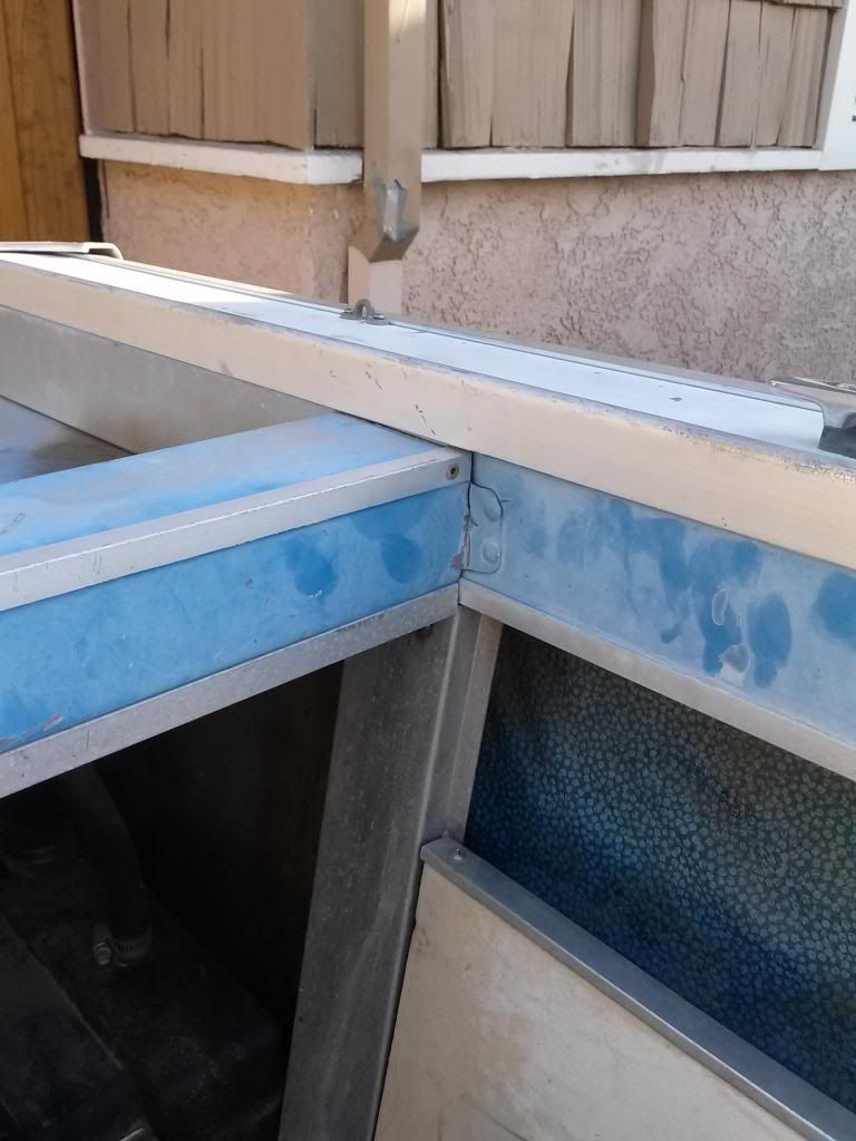

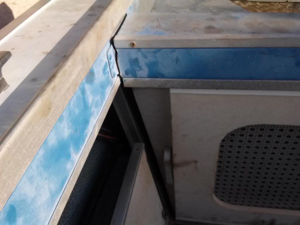

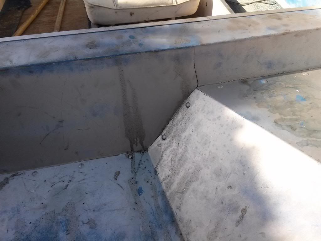

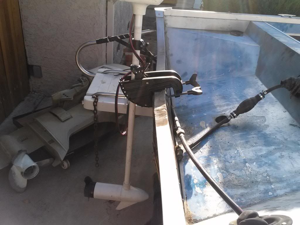

Well here are some before pictures. didnt get a chance to start yesterday cuz my mom decided to sod our whole back yard so i got stuck with that :facepalm: so starting today!!! please enjoy these way too big photos :D

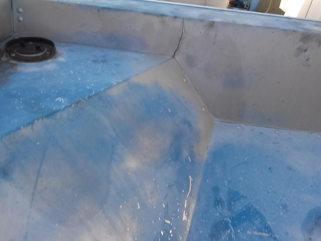

look at that bend!!! this should be fun!!!! even with that little trolling motor, i still get transom flex!!!! :lol:
Splashwell cracks
more cracks!!

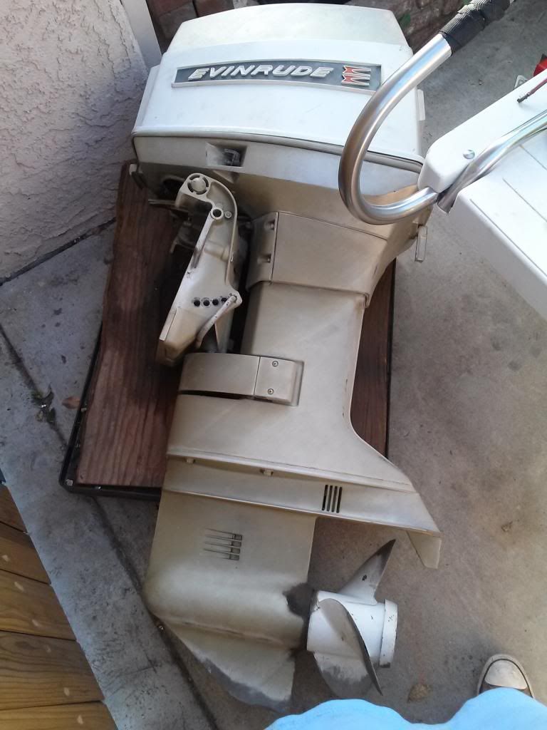

And even though you guys recommended i get a bigger motor, i feel i can upgrade later on.. outboard prices in california are STUPID crazy!!!! so i bought a scrap boat for 100$ and took the surprisingly well running 55hp and controls so i figure it should be ok for now.

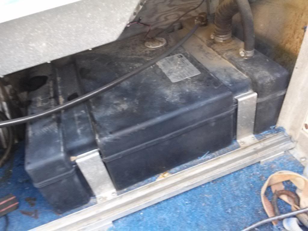

i even got a nice 11 gallon tank that fits with a sending unit!!! :0

It's obvious why the knee braces are cracked after seeing the splashwell and transom. Somebody ran her into the ground, but the good news is all of that is fixable. The motor will be fine to get her on the water after you get her all fixed up.

Yep a $100 RUNNING 55hp is outstanding. And if it puts you on the water sooner AND cheaper, all the better.
Where do you live again? If the OB goes missing, me & the sargent know nuthin' & saw nuthin' :rolleyes:
Splashwell cracks & a bent transom, bummer, but it can all be fixed........

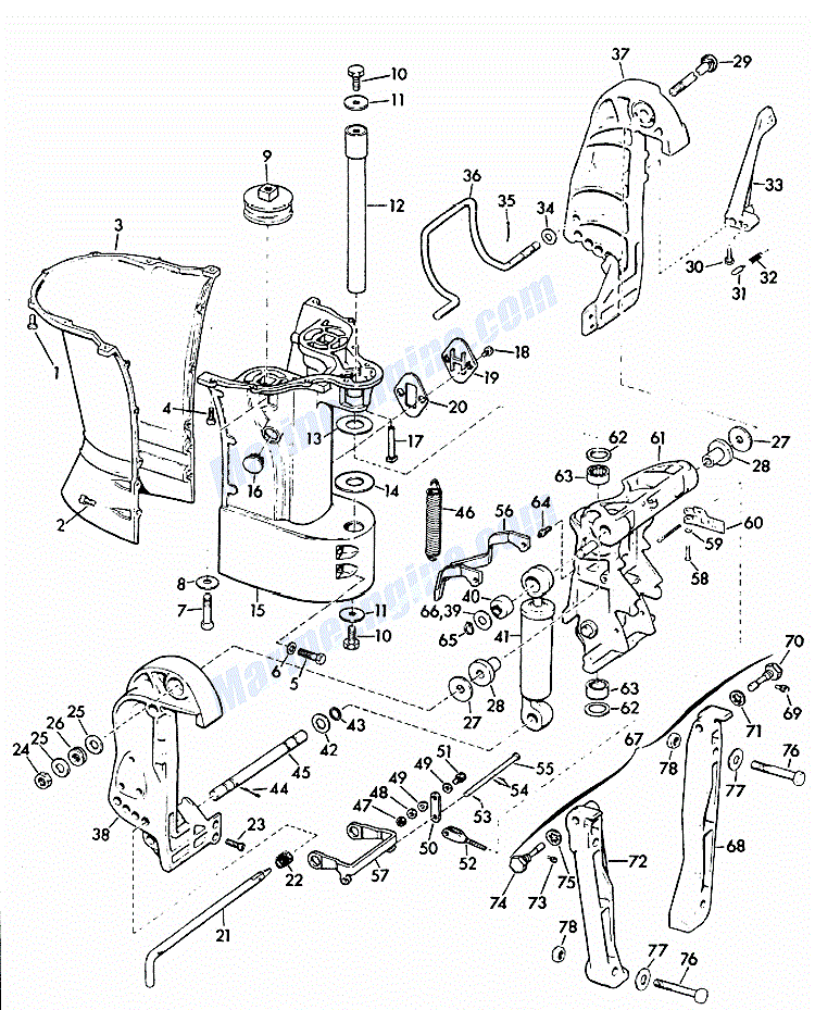

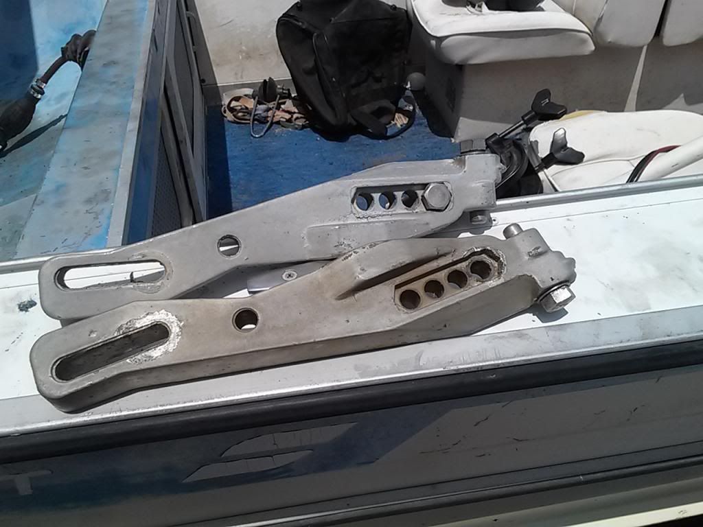

Hahah im out down in southern california near la. Great weather but horrible cost of living >_> i think my neighbors are starting to hate me with all these projects over the last couple of years xD wish i had car access to my backyard or a useable garage >_> the outboards just sittin in my driveway next to the boat :lol: speaking of the outboard.... whats up with these?????
Those were used to mount the outboard on the old boat but ive never seen an outboard with the kind of mounting system before.... is it like an option or is it specific to certain outboards? Oh ya... and im hoping to be the youngest guy to restore a starcraft on iboat but thats just for fun :lol: :lol: :lol:

Yes those ^^^ are for some Johnson & Evinrude motors. Not sure when they quit using them, but I think it allowed you to mount the bracket to the transom securely and then you could remove the motor & relocate it correctly on the transom when you put the motor back on.
You can see them in the bottom right of this parts pix:
And here's a set on evil-bay

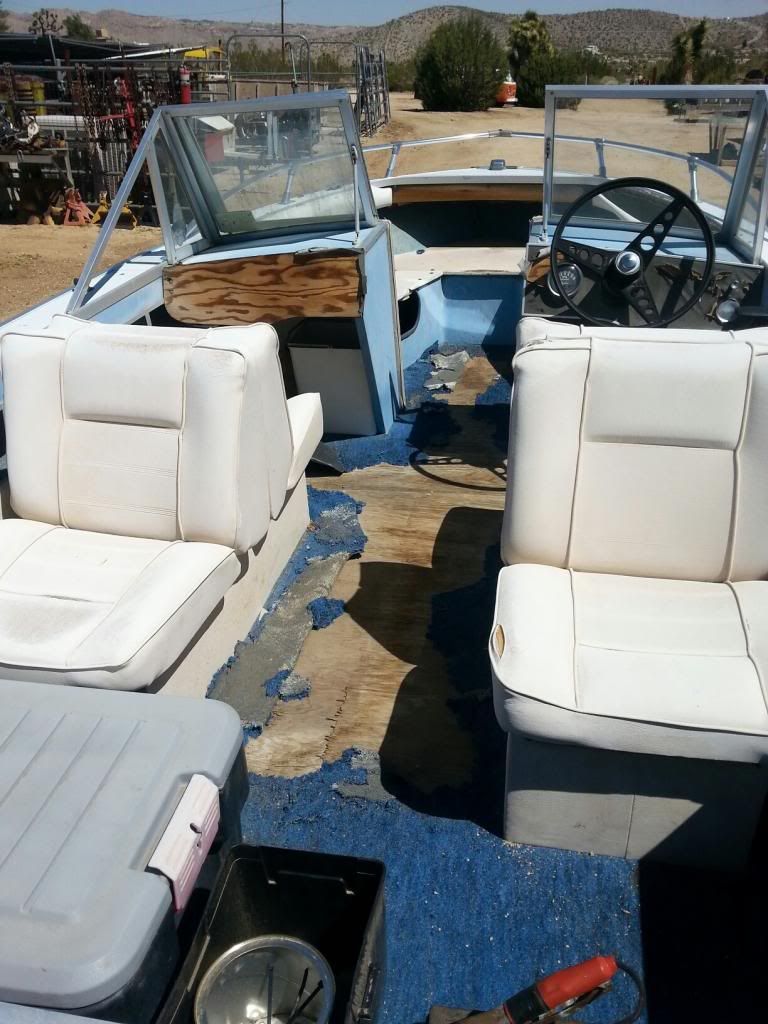

Ok... so.... its been really hot.. like 100+/- so i havent been able to do too much because the thought of getting burned is not appealing. Bahahah but.... there is new news..... i was bumming around CL for outboards in hope of finding either a temp summer boat or a cheap scrap with good engines.. well... i got one.... and theres micxed emotions. The 74 is gunna get restored anyways for fun. And i found a "scrap boat" their term not mine with a 1981 80 hp and an 81 4.5 kicker that were recently sevice for 400 bucks with the motors trailer and SCRAP boat. Drove 2 hours away to learn that this "Scrap boat" is a pretty decent 81 starcraft ss >_> hahahahaha so my cheap summer boat is another starcraft. Of the irony xD
