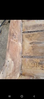

This is what I have right now. Also wondering along the sides of the channel it looks like rotting wood is that just discolored fiberglass from the rotting wood ?
