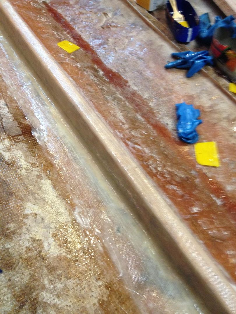

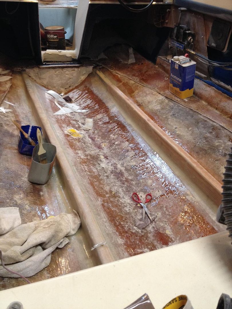

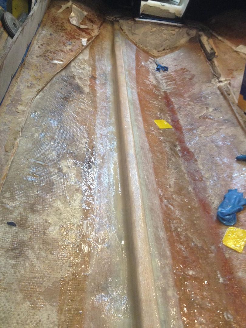

Well..had the heater going in the garage all night...and success!!!!

Hey now...That looks great Big Red! Nice stringer work. Awesome!

Very nice clean glass work. You won't see that kind of care in a factory build. Great job it will last for years!
