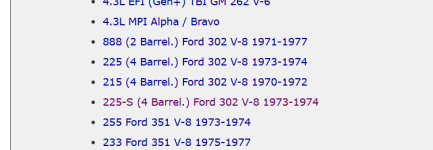

they did
in the link https://www.marineengine.com/parts/mercruiser-sterndrive-parts/
there are listings about halfway down for 302's
888 was 2 bbl, the 215, 225, & 225S were 4 bbl
of course these were a long time ago... if you click on the links tlo the carbs looks like the 4 bbls were all holleys, the 888 was made with both Rochester and Holley 2 bbls.
