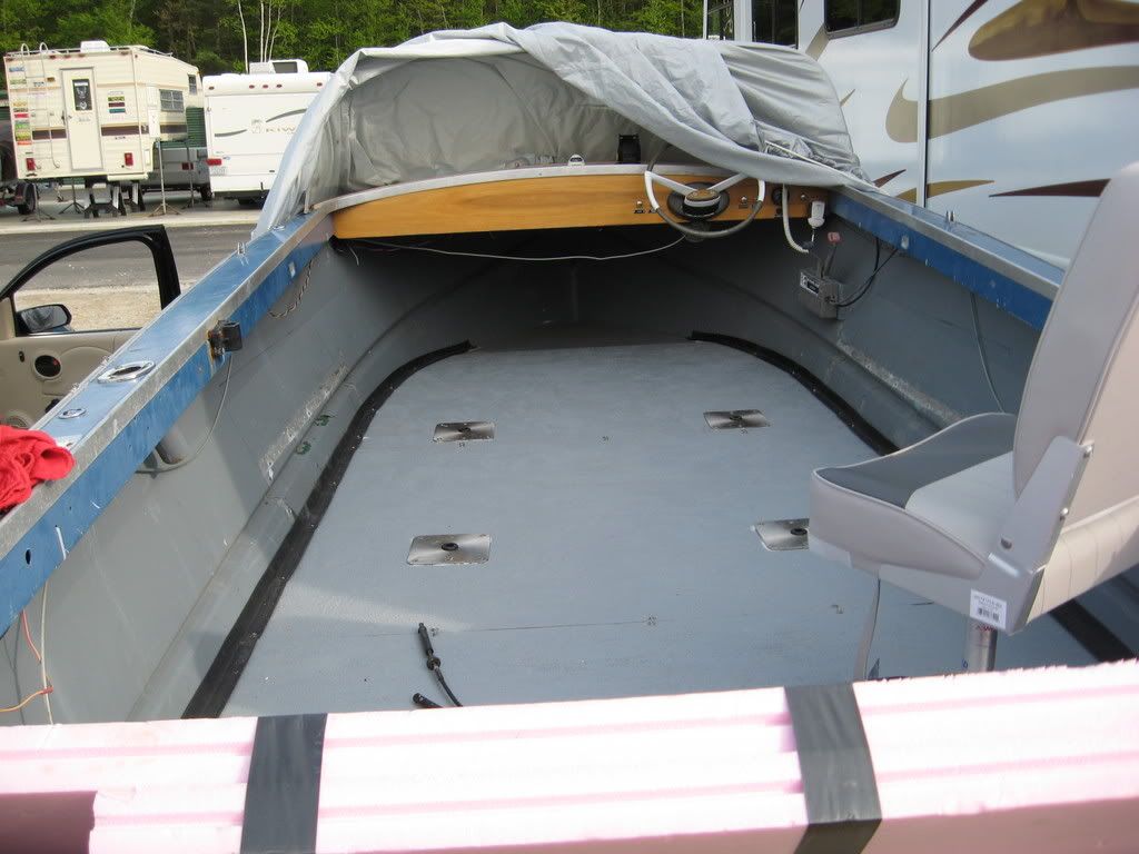

I just did this last off season on my 16' Starcraft. I pulled out the deck and foam. I used the existing floor boards when possible to cut the template for the new floor. I bought 5/8" regular 5 ply plywood, sanded it and coated it with gluvit. I used the extra plywood to re-inforce the seat pedestals. You will need a hole saw, a sander, a drill, a jigsaw, and a circular saw. Use all stailess steel fasteners, you won't regret it. I did not replace the foam. It's not really necessary, I just went with no foam. I made the floor removable with a little effort if I decide to go back in and do foam. I put in all new pedestal seats. Instead of carpeting you might want to consider tuff-coat paint from bass pro shopps. It only cost me around $75 to paint the deck, it looks great, and I don't have to worry about carpet trapping in the water. Always cover your boat, and it will last for 10+ years before it needs rebuilding again.
3 sheets plywood - $170
1 gallon gluvit - $80
1 gallon Tuff-coat and a quart of primer - $75
4 New seats/pedestals/SS bolts - $300
SS Bolts and other tools and stuff - $100-$150
Total - $775
You may want to consider rebuilding the transom while you are in there. Mine was just 3 sections of 2x10's dropped in.I cut new ones, sealed them, and painted them and used new SS bolts for around another $100.
You won't regret the time, effort, and money. It's fun and a great learning experience. Your boat will be just like new for less than $1000!

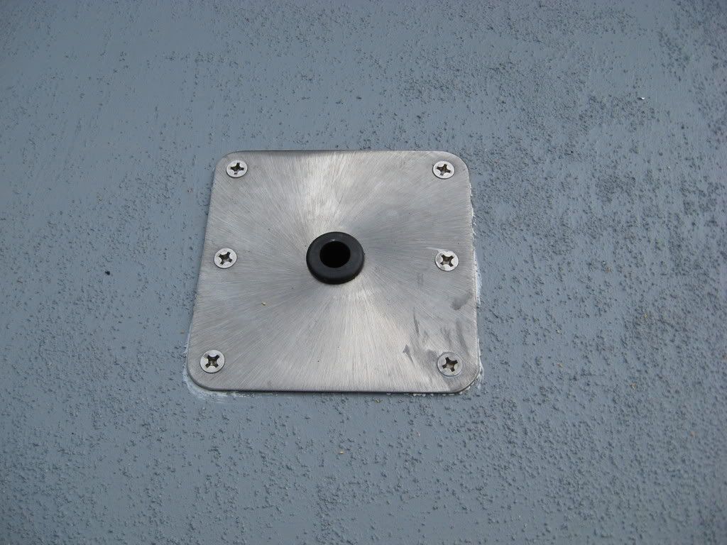

Here are some pics of my tear out and the new deck. I didn't get a lot of good in process pictures though. When I paint this season I will.
Here is the link to the entire album:

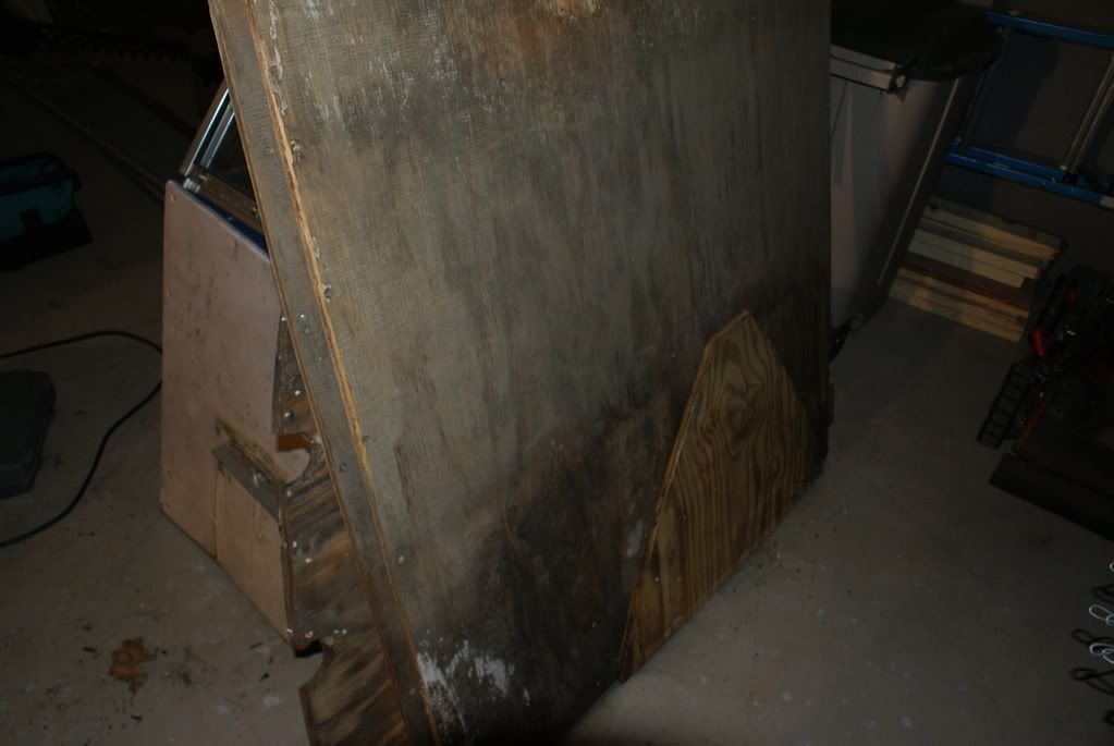

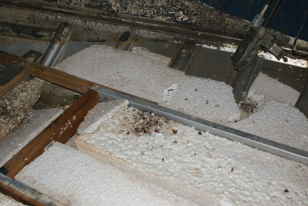

Here's a new update - Day "2" of the tear out and rebuild.
Here's the highlights - removed driver console, tore out old carpet, removed old plywood. Sounds simple enough, but with one drill and 2 drill bits sacrificed due to drilling out rivet heads. Anyway, here is how the boat looked when we started on day two.
And here are some shots of how it looks now.
Here are the pieces of the decking - we are saving these to be used as a template for the new decking.

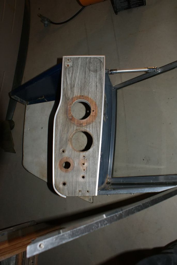

And here is the old driver's console - the wood panel look was done by some kind of sticker, but the plywood under the sticker is rotted so that will be replaced as well.
And here are the new switches that I have found to replace the old (and very corroded) switches, which were not labeled btw.

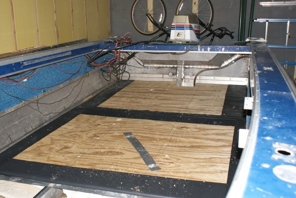

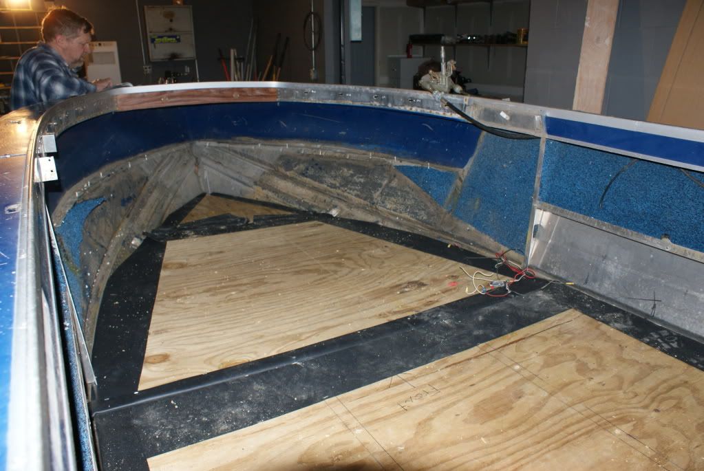

After we got the old floor out, we kept the pieces as a template. Most of the day was spent marking, cutting, sanding, cutting, and screwing the new floor into place.
The wood is treated plywood we picked up from Home Depot (I think) and allowed it 4 weeks in heated basement to dry out....which did the trick.
The black stuff you see on the plywood is a rubberized membrane that my uncle picked up from somewhere, the entire bottom of the plywood has the rubber membrane, and then it overlaps about 4 to 6 inches and then fastened into place.

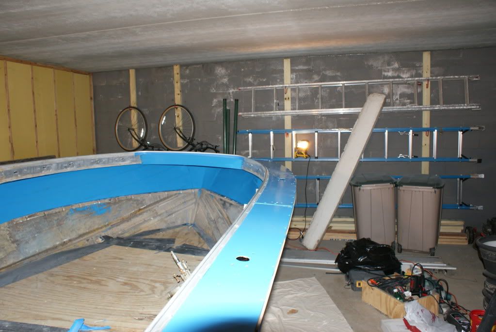

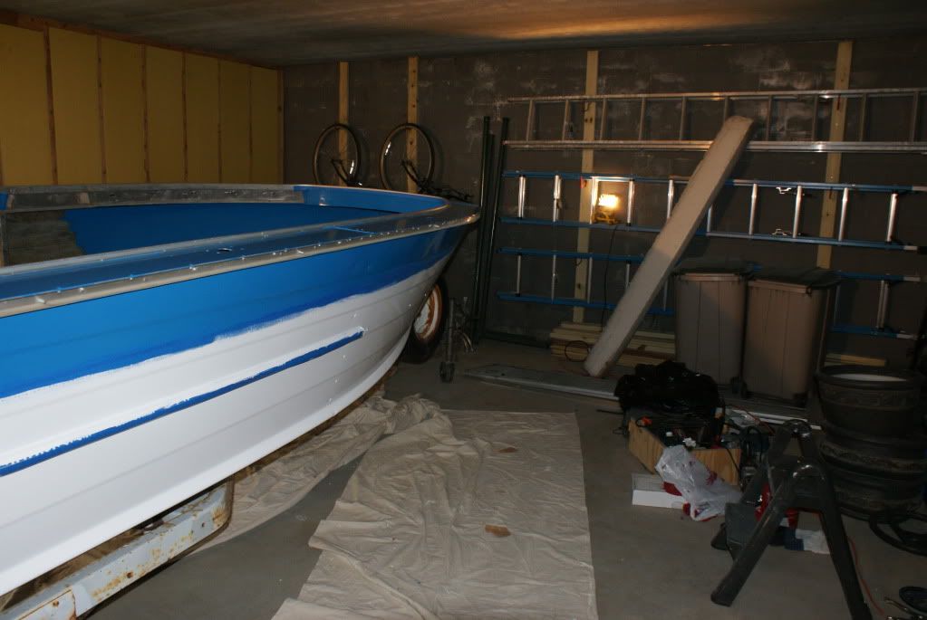

After we got the floor in, we moved on to the repainting part of the project.
We removed every single bolt and broken rivet that we could and then we began sanding....and sanding.....and sanding.....and did I mentioned we sanded???
Once the sanding was completed, we started with the largest part of the color which was white...my cousin and his friend did the whole boat white with the rolling tip method and put a nice three coats on....looks wonderful....
I came in the next week and did the blue.
here's some photos.

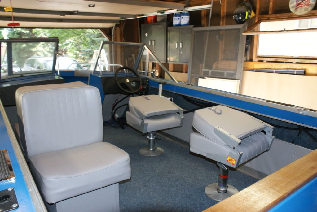

Well because I didn't bring my camera with me every single day, I missed out the last few days we worked on the boat.
But to sum it all up, one day was spent gluing the new carpet in, wrapping the matching gray vinyl that I had order to match the seats around the two side pieces. Attaching the new rub rail and installing the insert.
We moved on to reinstalling the consoles, then the windshield parts, then I cam along and did the wiring, finally we got the front bench seat all done.
For the replacement dashes, instead of diamond plate, I came across something that I thought would work a lot better, black marine board.
Well, see the final results of our hard work....this was completed 4 days ago as of this posting and I cannot wait to take her out on the water.

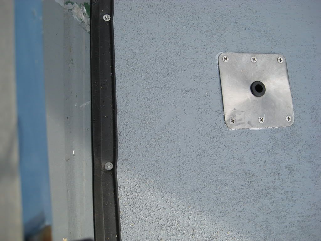

Oh...hehehe I should also mention the Gray stripe along the outside of the boat in-between the blue and white.....that wasn't in our original plans....that was added to cover up a boo boo....we put two widths of blue painters tape and when we peeled it off, it left a nice 3 inch unpainted gap between the blue and white.....so we came up with using the gray to match the gray vinyl.....an oops that made it look better in my opinion.
The boat registration was custom made for us by a company called lettertech in St. Paul MN
We switched the old lights out for new LED versions and we added a new bilge pump. We wanted to add a radio like the one switch is for, but we just haven't gotten around to that yet.

Yup, looks good. I liked the grey "oops" stripe also...it's a nice accent to the blue. I don't entirely understand the rubber membrane though. Is that under the floor, or above it, with the carpet on top of that?
Maxx102
Aug 31, 2008
43
Re: New here, season coming to an end, family wishes to overhaul boat
The reason for the rubberized membrane is to prevent galvanic corrosion - which I learned from here - treated plywood and aluminum don't react well with each other, so we used the rubber membrane. The preferred method is to fiberglass the wood, and then install it (I think) but that was a little beyond our budget.
The carpet is installed on top of that and when you are walking on it. you really can't tell where the seams are..
