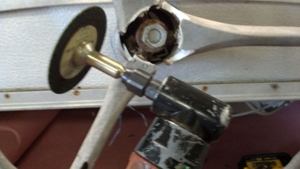

It was being problematic to get the wheel off so I improvised. I'm having trouble pasting multiple pics so this will have to do.

Can someone help me figure out how to separate this mechanism so I can pull the tin off for my template? The thing has to separate somehow but the Norwegian in me isn't comprehending.

if you look up inside of the cable race on the backside there will be an interior snap ring like this...
At least there was on mine, and it looks exactly like yours. You need special snap ring pliers to remove it. HF sells em for $4.00 bucks.

I take it thats the center piece which has the woodruff key inside it. Obviously you're replacing that helm so I would take a couple of pipe wrenches or a big crescent on the nut below and the pipe wrench on the piece with the woodruff and twist it apart.

Computer is going wacko. Here is the other side I intended to say. I pulled a snap ring off the other side but that still doesn't look like it will separate it enough to pull it through the hole in the tin.

Wood and Water, I see your posts now. I'll take a closer look. Yes, the last pic shown is the key way side. Thanks for the help.

Here is the entire piece. Getting the big wrenches out now.....

That Brass looking ferrule is keyed and slipped on a tapered shaft. I had to HEAT mine with a propane torch and then use a BF Hammer to BEAT it off with a flat nosed punch from the opposite side. It WAS cantankerous FOR SURE!!! It was a VERY FRUSTRATING PROCESS!!!! I think I used Liquid Wrench Too!!!

As suggested some heat,a punch, BFH, Blaster penetrating oil, and some Norwegian anger persuaded it off.......thanks man!!!!!
