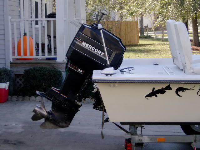

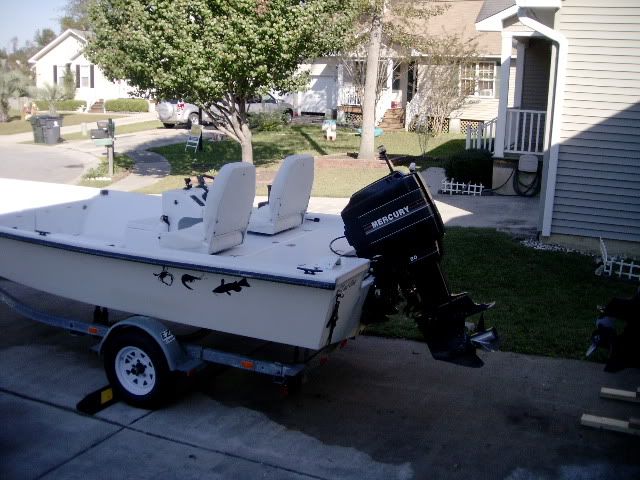

Picked up a deal on a 89 Mercury 80 HP and got it mounted. Still have about a weekends work of work then she should be ready for a sea trial.

Picked up a deal on a 89 Mercury 80 HP and got it mounted. Still have a a weekends work of work then she should be ready for a sea trial.
Looks real good!!

Well after some long hours and days and alot of dirty looks and comments from the wife I put the boat in the water today for the first time. I still have a little bit to do in the fuel tank area but I wanted to make sure I did not have any leaks. I just used a portable tank installed today. Everything I think went very well. The 80 HP Mercury pushed the boat well. I estimate speed around 30-35mph. Dont have a speedo in it yet. Boat seems to struggle a tad to get on plane but once there it runs well. I am a new to the bigger boats and am still trying to figure out the trim settings. Should I take off with moter trimmed up or down. Ran up and down the canel a few times and decided to call it a day. I still do not have it registered and did not want to take a chance running into DNR. Getting it on the trailer was a bit differant than my jon boat. I think I had to much of the trailer in the water and struggled keeping it centered but will try some other stuff next time out. The really only issue I had was when in reverse It would jump out and make a rachet noise like it was not all the way engaged all the way. I am going to try and adjust the cable some and see if that helps. All in all I think it was a good outing. Rig is 95% complete and just need to finish the last 5. I added a couple if pic of my prod moment. Thanks to EVERYONE on Iboats for all there help and for putting up with all the sometimes dumb questions.

You want to start with motor trimmed all the way down.

As for trim... start out with the motor trimmed all the way down and as the boat starts climbing out of the hole, start slowly raising the trim level. After awhile, you'll get a feel for what the boat likes best. And that will change all the time, based on load, wind, waves, etc.
