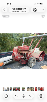

I picked up a Troy Bilt tiller yesterday looks to be a junior model. It’s in over all good shape and is well worth my effort bring it back to life.
The carb is pretty rough and has a lot of internal corrosion and the needles are shot but it should at least be good enough to see if she runs. It turned out to be a mouse house as well but there was nobody home.
