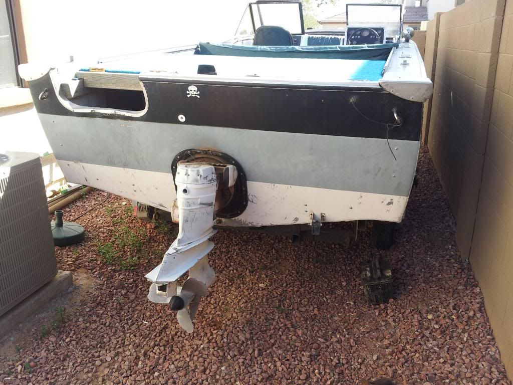

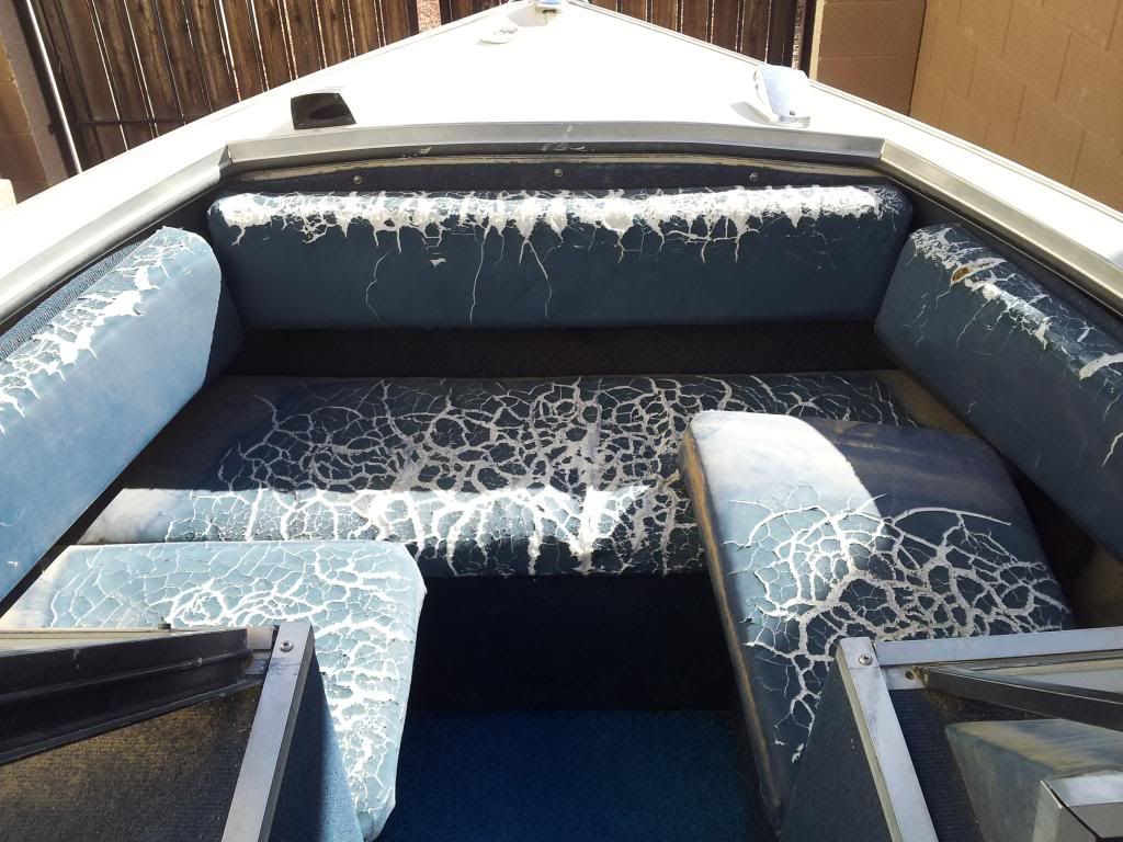

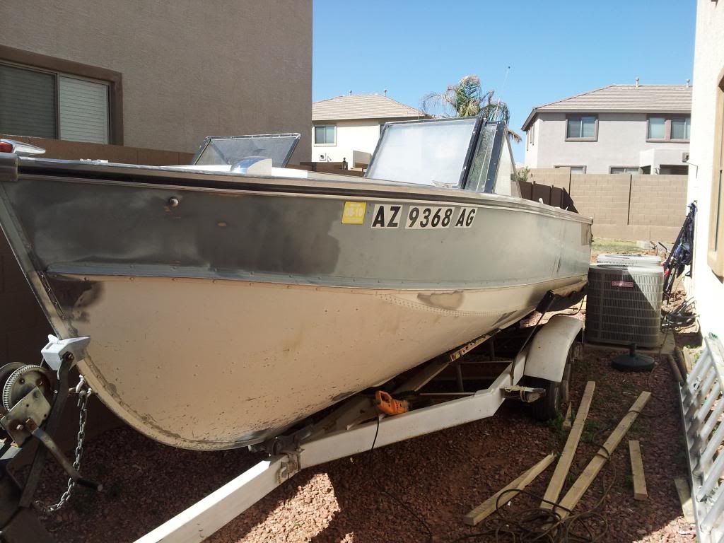

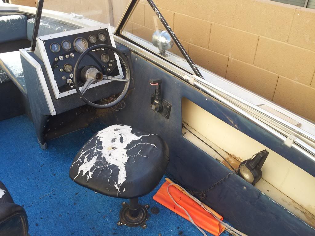

Re: new to everything
It's a little embarrasing to show the pics but I can see past the cosmetics. There are no dents/holes in the hull but some minor scratches and fugly paint. I would like to get some paint and interior work along with replacing all the oil, water pump in the drive and whatever else I need to get it out on the lake for the summer as stated above. Then come fall I am going to rip up the floor and redo the whole boat for next summer.
Its a nice strong looking craft, there are huge differences in design and build between USA made and Aussie made alloy boats, engine looks like a Ford Windsor V8 no probs with parts there, manifolds and risers are still around plus theres aftermarket now, the drive itself Id throw away, my preferance would be a Mercruiser leg, remembering companys like Mercruiser used a multitude of different engine makes, guessing its no race boat, what exactly you plan to use it for you havent gone into, boats are a bottomless pit for money just depends on how far you want to go, the upholstery is easy, unpainted alloy boats seem popular over there, in the main there painted here, if it was my boat Id gut it to bare bones and start with the hull, paint or polish? check every weld and rivet, are the floors timber? are they rotted? do you want to keep the V8? looking at the transom if it was mine Id turf the 8 and the leg, rebuild the transom to take an outboard, turn that engine bay into a live bait tank or beer cooler!, the sky is the limit mate.
