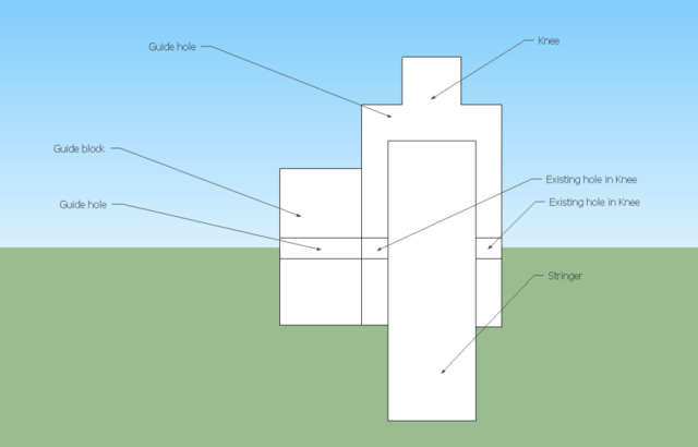

Are those "thru holes" with bolts/nuts holding them in place? If so I would just drill new holes. Start by mounting to your new wood on transom, then you can use the knee as a guide to get your new holes drilled in correct location. I would also pre drill a small block of aluminum or wood then line that hole up with the existing hole and clamp it down. This will aid in preventing your drill from wandering all over and elongating your hole.
I think I'm getting what your suggesting.
I know for certain the fastener holes through the stringers at the base of the knees will have to be moved forward roughly 22/32nd's of an inch, or the length of the additional layer of ply I added to the interior.
I suppose I can apply your logic to where the knees mount to the transom as well, if I first secure the knees in place I could then drill through, inside to outside, and straight through the aluminum, to get my final fastener location.
Sorry I know this isn't very easy to understand through typing.
I still just am not sure if the original 8 holes through the aluminum skin will correspond with the new holes I drill in my transom, with the knees forward that is.
Basically I really want to avoid drilling, and then having two sets of drill holes RIGHT next to one another, or worse, enlarging the existing holes.

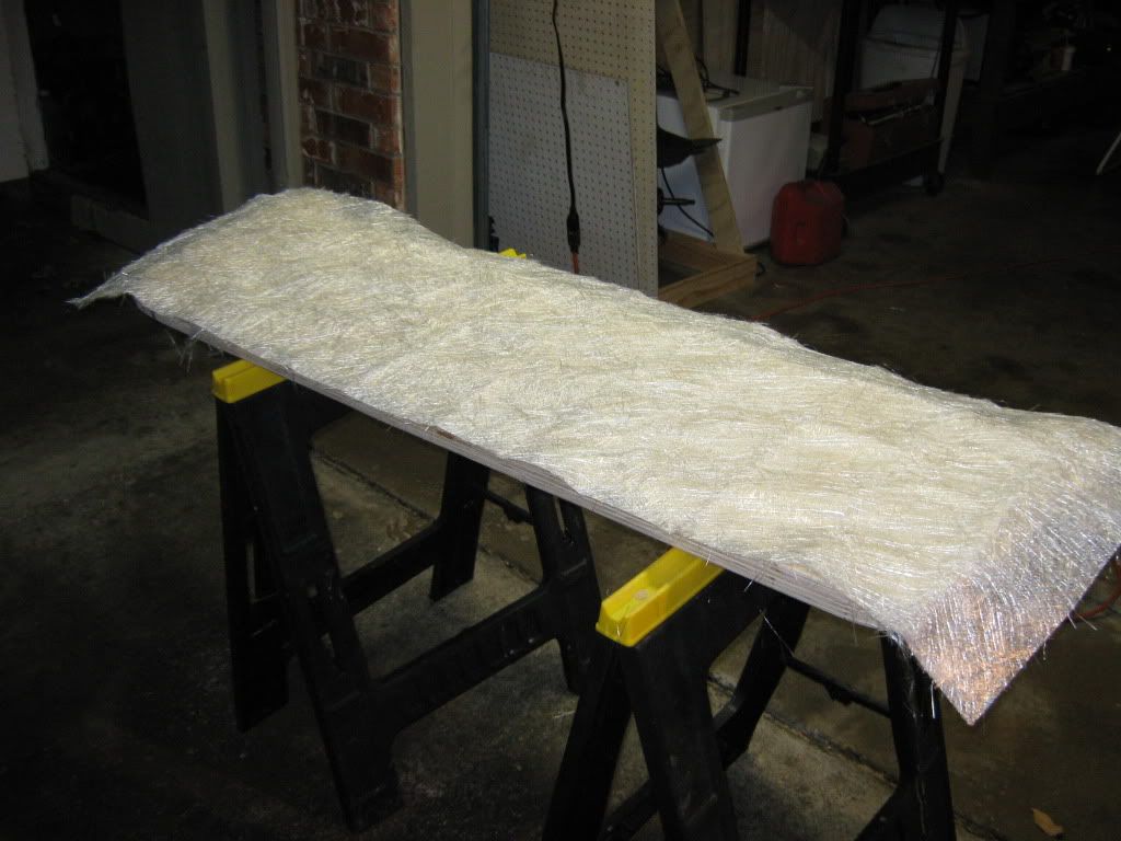

I just finished glassing my transom, sorry I don't have pics right now, they'll be uploaded later.
This was my first rodeo laying glass and have some questions regarding it.
First off I was using the 8 sq ft packs of 3m CSM available at HD.
The size was actually perfect for my transom as they were roughly 4'x2' and covered my transom with room to wrap around the edges.
My main concern is how much resin is this mat supposed to take?
I was completely caught off guard with how much it took to wet all the mat down.
I started by pouring resin onto the bare wood and spreading it out and then laying down the glass.
I kept pouring until all the air bubbles were out and it layed down completely against the wood.
I used at least half a gallon of resin to get it to do this though!!
Also, when applying resin to CSM is it best to NOT try and spread the resin out?
I ask because I tried to spread it and my CSM started falling apart and shedded chunks off and made an awful mess.
Should I have just poured the resin onto the mat and let it absorb it all?

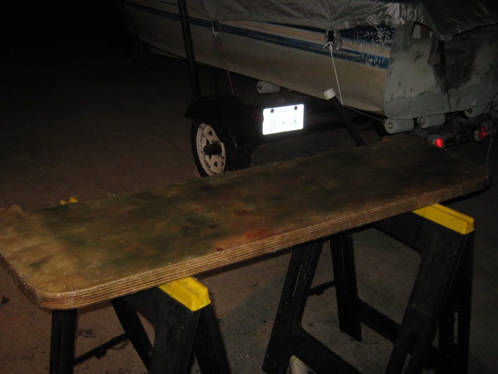

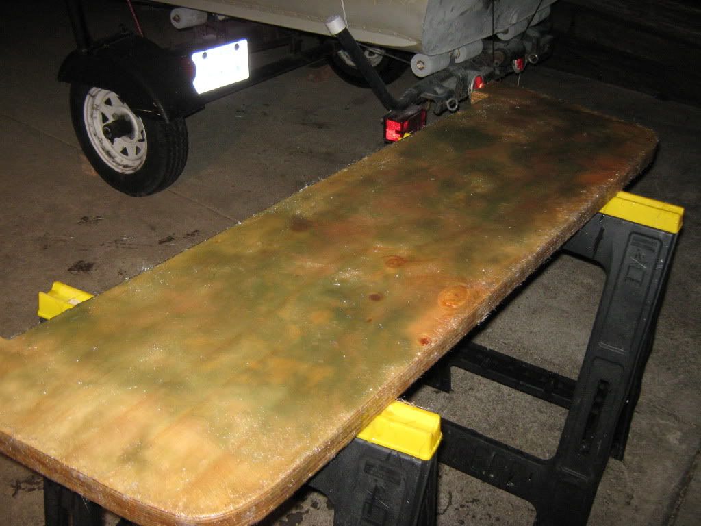

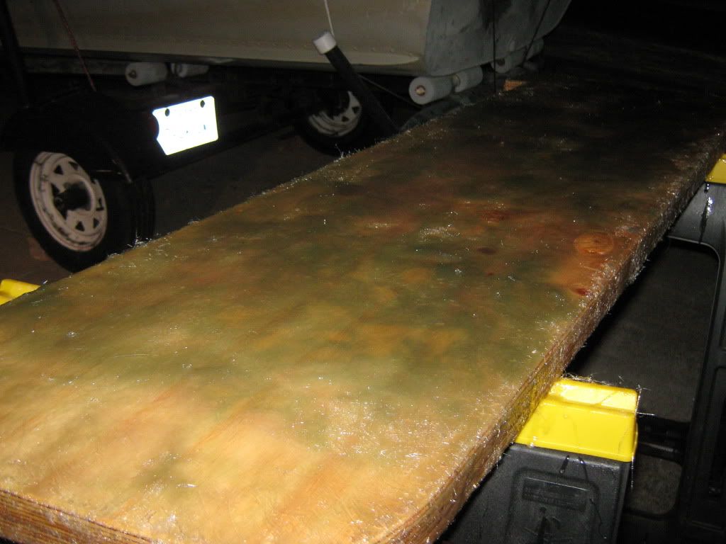

Ok, here we are with some pictures.
Sorry I realize they're not the best but after all its pitch black outside.
I realize there are strands of glass I will need to sand down before installing it but the glass did lay down underneath.

Re: New User Introduction.
Ok not as bad as your description led me to believe. I'm still concerned about delamination since you did not precoat the plywood first and let it dry. Guess we'll just have to see. I'd really inspect it well and make sure there are no voids especially on the edges. If you have any doubts, sand with 180 grit, wash with acetone and apply more CSM and resin to the suspect areas. Once satisfied that it is totally sealed and waterproof, sand it all with 180 grit and wash with acetone. I would then give it 2-3 coats of Rustoleum Oil based paint and call it good.

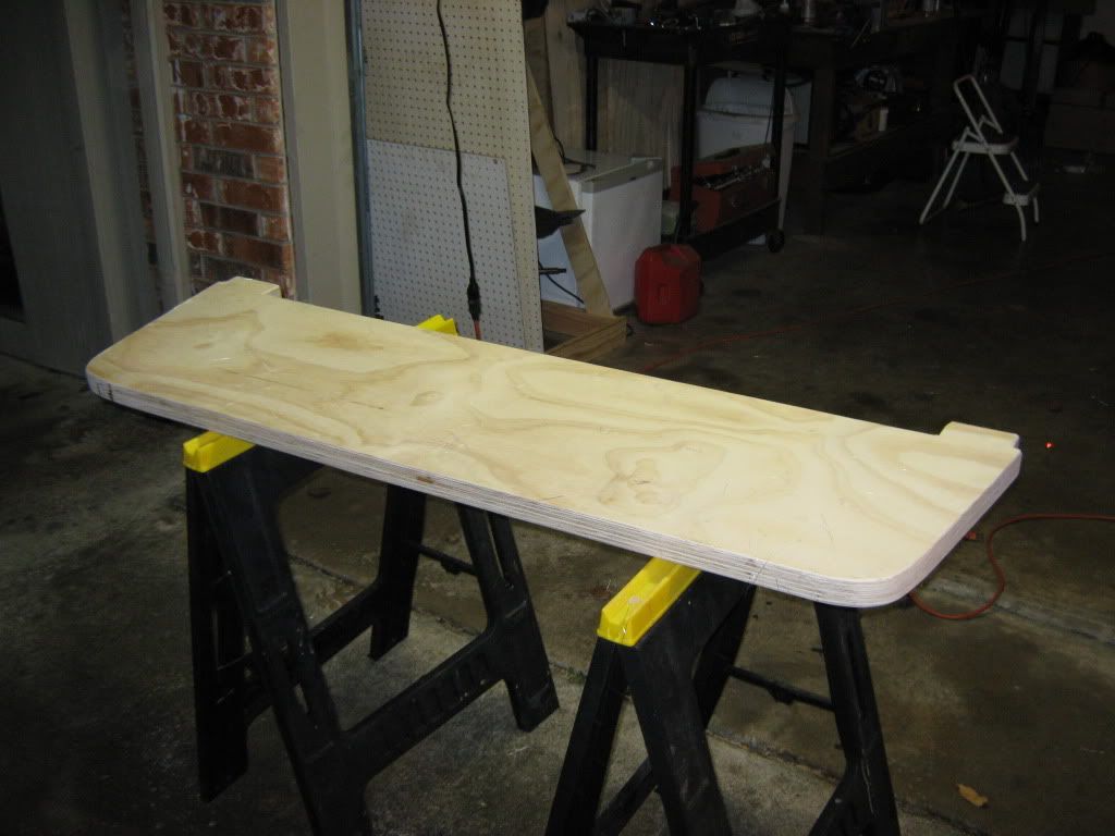

Well I pulled my transom out of the shed where I had it drying to begin sanding and had to stop because I am simply too frustrated to operate tools.
The glass started ripping off in chunks where it didn't adhere to the wood underneath.
The worst areas are around the edges.
What I would really like to do is remove all the de-laminated material, sand, and then epoxy the whole thing.
What, if any issues will there be with this plan?
