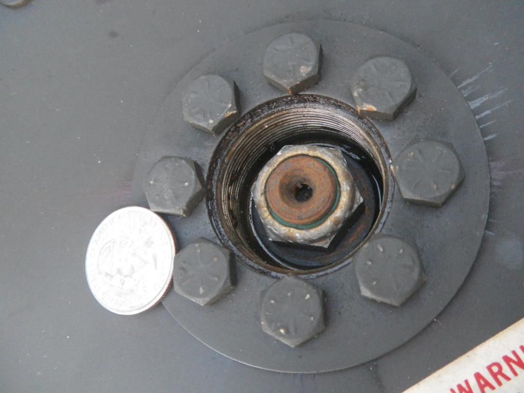

Where does this install? I just went out and looked at the motor. I dont see anywhere that it might fit. Unless it is about 2 inches in diameter. Then it will screw into the hole in the center of the flywheel.
I was thinking of getting two large washers from work (train parts) and drilling one to fit the 6 flywheel bolts. Cuttin the other and welding it to form a loop on the other washer....

Bingo that's where it goes right in top center of the flywheel/ top of crank.

Cool. It doesn't look that large in your pic. It's gonna have to be 1.5 inches in diameter or so...
Not arguing, but seems like a bad idea to lift a motor by the crankshaft. Maybe it's just me. haha
All of my previous motors had lift points from the factory attached to the block. Or were just light enough to lift off by hand. haha

Trust me this is where it goes and it is designed for lifting the Mercury and Mariner Motors.

Anyway. Yeah, that piece is much larger than it looks in the picture. The picture made it look like it was maybe 1/2 or 3/4 inch shaft diameter.
Do you have a part # for that thing? I have looked and there are several different styles available.

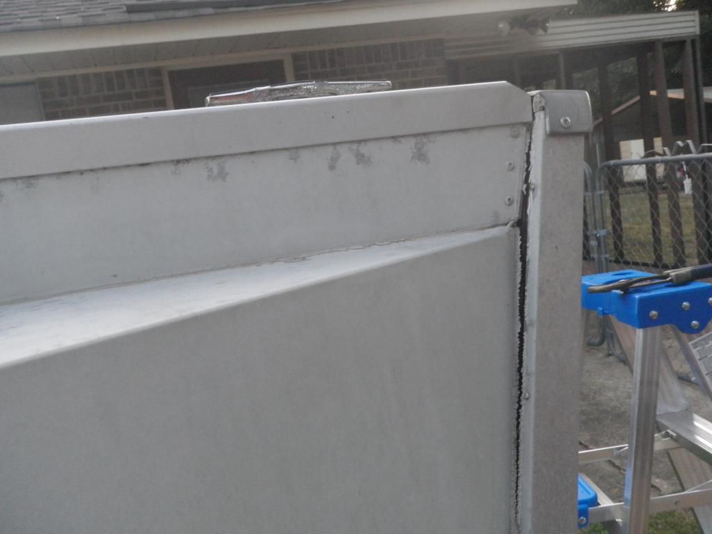

We got the motor off today. But we founs some cracking in the transom and some separation of the splashwell from the transom and the gunwales. The separation at the transom and gunwale looks like it may have only been held in place by some sort of sealant like 5200. But there is a crack in the aluminum right where the splash well turns up onto the transom. The wood is GONE, so the aluminum was holding the full weight of the motor. I'll get a few pics up tonight ot tomorrow to get you guys' take on it... Too tired right now.....

Man! I forgot to add the pics from last weekend's progress. I got the engine off and a stand built for it. When I bought the boat in New Orleans, there were no cracks around the transom. The wood was so rotten that on the ride home, the splashwell started cracking and separating from the gunwales. I hope I can fix this.... Here is the transom sans motor..

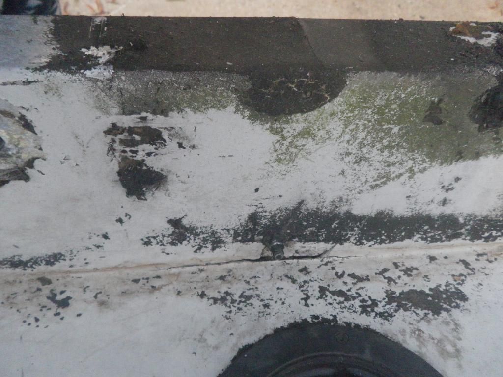

When I got the motor off, I found this under it. This is the top edge of the transom. It is not surprising considering the crack at the base of the splashwell/transom joint. This occurred on the way home with the boat. Even thought motor had a transom saver on the motor. The wood is that rotten. My buddy can weld these up.
The motor pulling on the transom also cracked the angle joints at the front of the splashwell. He can weld these as well.
Here is where I'm getting scared... The transom has pulled away from the spalshwell. It appears to have been secured with some sort of 5200 type sealant. I'm hoping that it is not so warped out of shape that I cant get it back...
