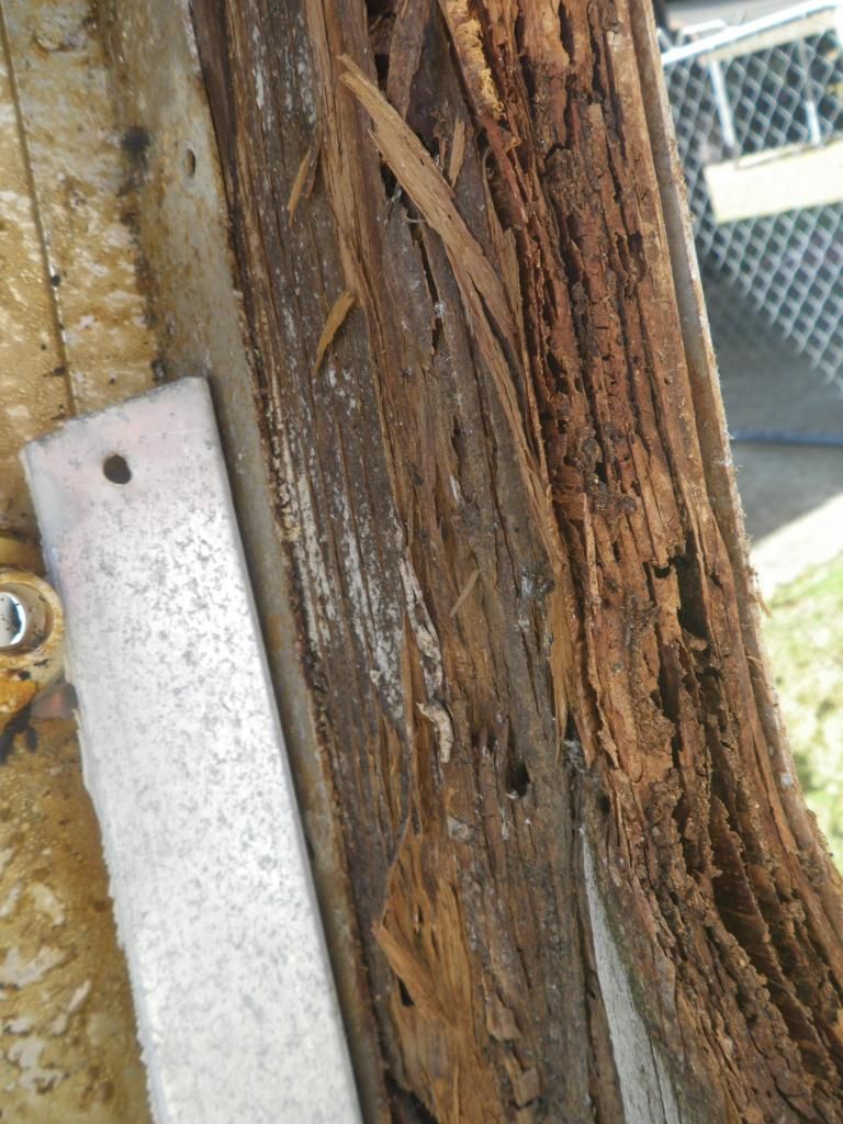

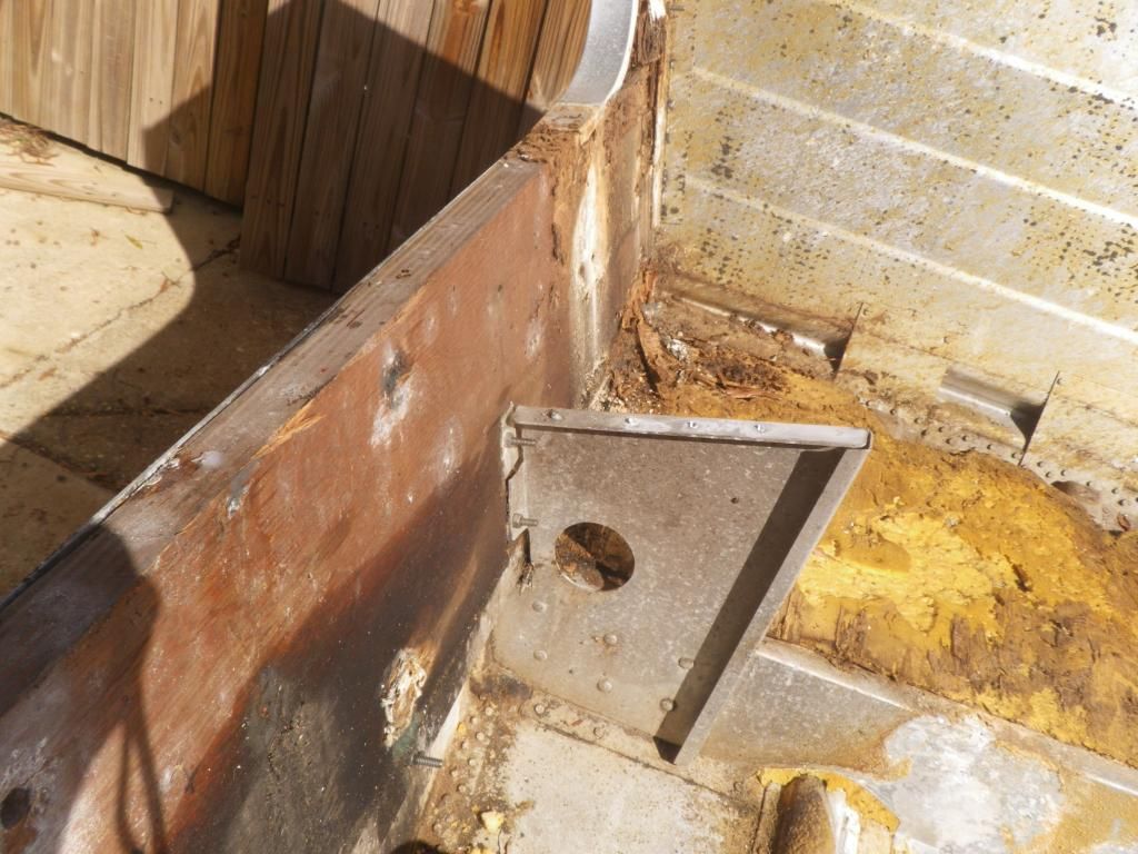

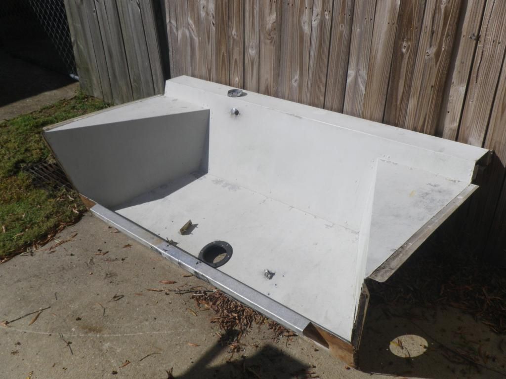

I got alot done today. I got the stripped stainless screws drilled out of the rubrails. I also for the splashwell out as well as all of the wood removed from the transom. All intact! It is completely rotted and dried out. It is like 1.5 inch thick tissue paper. haha I also got all of the foam dug out from under where the splashwell was. I was pleasantly surprised at the small amount of corrosion on the transom, but I did find some significant cancer in the seam where the bottom meets the transom. But none of it is through the hull. That I can tell. There is still a good bit of white fuzz. I have soaked in down with vinegar and will get a wire brush to it tomorrow.
Both of the knees are cracked and broken where they bolt to the transom. I am trying to decide whether to weld them back or trim the broken flanges off and replace the flange part with something much more significant. Maybe a new 3/16 or 1/4 inch aluminum plate riveted to the original.

Uh Oh.... I went out there this morning and did a little clean up. I chipped at the white fuzzy and took the shop vac to it. It is much worse than I thought. There are several spots wher it has eaten most of the way through and one place where there is some perforation....
Now what to do? The areas are too large to fill weld. MAN!!! I dont want o rivet in a whole new transom.. But I dont want patch panels on the outside either...
Any suggestions? The bad spot is only about the size of a nickel or quarter. Not the whole hole. There are just a couple of pin holes, but the eaten spot is about quarter sized. Then there are several more that are not as bad, but are palm sized at the largest.
Crap! I just got out there and did some more cleaning... Found a few more perforations. All are a collection of pinholes in areas the size of a quarter or less. :-O
Up to 5 or 6 areas now...

Hey don't panic Nismo, it's very common and remember it's just a skin to keep water out, the main support is the transom wood. My Chief had very similar problems being salty and so did C Cat on his SS. Be sure you drill out the rivets and take off the bottom Z channel so you can clean it out behind there too.
I just can't believe how people run these boats with compromised structure, that's what cracked those knee braces, running it with a rotten transom.

You might take a look for cracks in the splashwell, too. Mine had also been run with a heavy 6 cylinder OB on a rotten transom, and the well was cracked at the two lateral stress points where the 45* piece joins the vertical piece. It's an easy fix, too.

I dont think the cracking happened by running it. I think it happened on my way home. It was a 6hr drive. When I bought it there were no cracks in the splash well. When I got home, it was cracked right where the bottom of the well turns vertical to go up the transom. It was also now separating in the rear top corners where it meets the transom and the gunwales. Definitely not there when I bought it.

Sorry if this is super obvious to you, but you can just drill out the ends of the cracks, fill with JB original, then use more epoxy to bond aluminum flat bar under the cracks...better than new. And you haven't painted yet, so it'll be invisible once faired and painted.
