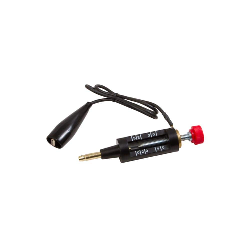

this is a really great tool to have so you can see the color (blue) and strength (gap jumped) of the spark
