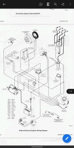

no, the boat uses a 1.5 ohm coil requiring a balast resistor for running and gets full 12 volts when cranking via the I/R terminal on the starter. that is the way the boat is wired.
Whoops. Everyone forgot that this is a 170. The 12v coil voltage is supplied by the slave solenoid, not directly by the starter.

Now the colors make sense! If the Pur/Yel wire looks good between the coil positive and the slave solenoid, then run a jumper between those two points just to make sure there's not a bad spot somewhere you can't see. If the engine still won't start there must be something wrong with the solenoid, right?

I checked the + terminal on the coil with key on. Read 12.5 volts. I was checking the slave solenoid & I noticed the kill switch that I removed a yellow & green wire from earlier this week, I neglected to connect both ends. So I re connected as in the picture.
Before doing anything else I turned the engine over with the key. I thought I saw the spark plug tester spark, it may have been a weak one.
I connected a jumper from the coil to the slave solenoid purple & yellow wire. Turned the engine over & it cranked up, the key would not turn it off so I quickly removed the wire. Actuality the 1 st time I connected the wire the engine turned over with just the wire connected!
Anyway, now it fires up like it should do normally.
