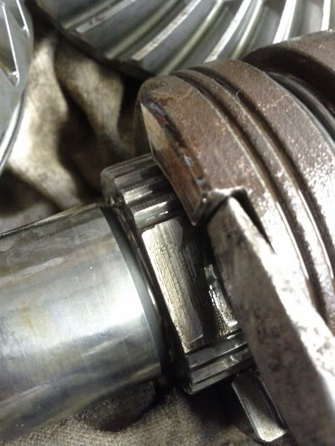

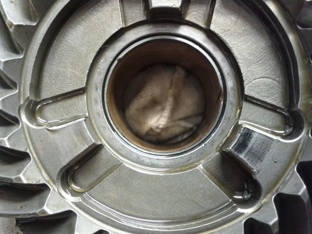

what year OMC outdrive? if its happening sporadically you could be having the same problem i just encountered...i had a clunk every once in a while,got worse and worse...i sent it to waterworld in durham nc...the young guy said it was the rubber in my prop,my prop was nicked up so i bought a complete prop. when i picked the boat up i spoke with the owner(about 60yrs old ) and he was inquiring bout my satisfaction with waterworld and the nature of my problem...i explained,he chuckled a little. he looked at my old prop and said yes you definitely needed a new prop,BUT that wont cure the problem. im now seeing $$$$$....and more $$$$$ lol, my boat is a 86 sunbird with the omc cobra outdrive,apparently there was a recall on these outdrives because of the degree of pitch on the clutch and gears,supposedly they come stock with a 2.5deg pitch and it wasnt enough,so they went to a 5deg pitch.
heres some pics for your viewing pleasure
if you look closely it appears this problem happened before on the fwd/rev gears because it looks like they switched f/r so they wouldnt have to buy new gears/clutch
