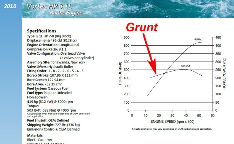

Did I mention that the STOCK 325hp:rolleyes: lq4 6.0 makes OVER 300 ft lbs at 800 rpm? Can you say GRUNT?

(NOTE: Notice how the torque and HP curves don't cross at 5252 RPM. Figuring out why is left as an exercise for the reader..... :))
(NOTE #2: This is a manufacturer's chart produced in accordance with SAE J2723. Up to you whether you want to believe it or not! :D)
Yes, because the TQ and HP are on different scales.
if you look, at 5252, the actual numbers represented by the graphs are the same.

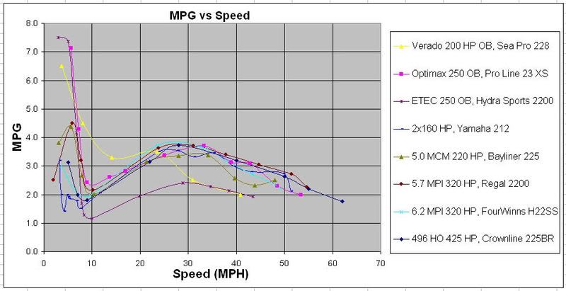

Do you have any kind of data on the 6.0 fuel mileage? Hopefully your other claims have more validity than this one. If you do any kind of research you'll quickly find that on boats of approximately the same size, the engine is pretty much irrelevent when it comes to fuel mileage. Water drag is so high that other factors become very minor. There is only so much energy (HP) per gallon of gas. Makes no difference whether it's a 496, a 6.0L, or a 5.0L, you're going to be burning the same amount of gas to propel the boat at a given speed.
I plotted the speed and mileage numbers on the graph below from Boattest.com when I was looking for a 22' bowrider. You can see just how bad the 496 sucked :) compared to a 5.0L, 5.7L, 6.2L, a couple of outboards and the Yamaha dual waterjet . I would be very interested if you have anything that shows where a 6.0L would be any different.
