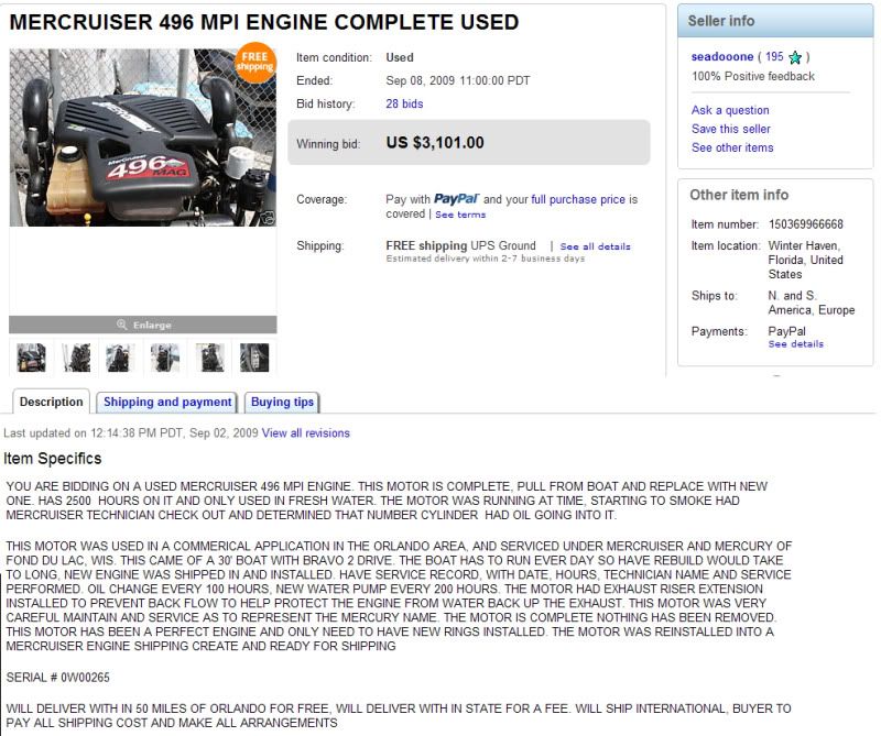

I would hope so. The 496 below that sold on Ebay last month was still running (but smoking from one cylinder) with 2500 hours on it. I'm averaging 80 hours/year on mine, counting on it to last about another 25 years ......

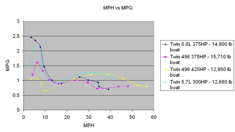

Found these tests looking for something with a new marine 6.0L in it. Only thing that I could find was a big express cruiser with twins. They had a couple of similar sized 496's to compare them to. Also had one with twin 5.7L small blocks.
Four Winns V358 - Twin 6.0L 375HP - 14,800 lb
http://www.boattest.com/boats/Boat_video.aspx?ID=990#Test-Result
Formula 34 PC - Twin 496 375HP - 15,710 lb
http://www.boattest.com/boats/Boat_video.aspx?ID=2000#Test-Result
Formula 350 Sun Sport - Twin 496 425HP - 12,950 lb
http://www.boattest.com/boats/Boat_video.aspx?ID=1649#Test-Result
Bayliner 340 - Twin 5.7L - 300HP - 12,660 lb
http://www.boattest.com/boats/Boat_video.aspx?ID=1695#Test-Result
Once everything comes on plane at around 17 MPH they're pretty even up through the mid 20's. Then you can see an obvious difference where the efficiency of the two lighter boats keeps rising while the two heavier boats are falling.
In the lighter boats, the twin 350's are slightly more efficient but about 15 MPH slower than the 496's.
In the heavier boats, the twin 6.0L's are slightly more efficient but about 10 MPH slower than the 496's.
Once you get above about 25 MPH the efficiency falls in line with the boat weight, lightest on top to heaviest on bottom. When the smaller engines in each group start running out of power about 37 MPH, the larger engines become more efficient and also keep delivering more speed.
Doesn't appear to be anything exceptional either way about the 6.0L performance.
Those are HUGE boats.
Stock for stock thats a given when compared to a big block.... I was talking about a hot 6.0 compared to a stock 496. If both of those 6.0's had the heads, cam, and headers that you could buy from the price difference the test would look alot different.
I'm impressed that you could find those charts though.... although it's hard to make a judgement when they are in different boats with different weights and different hull designs.
